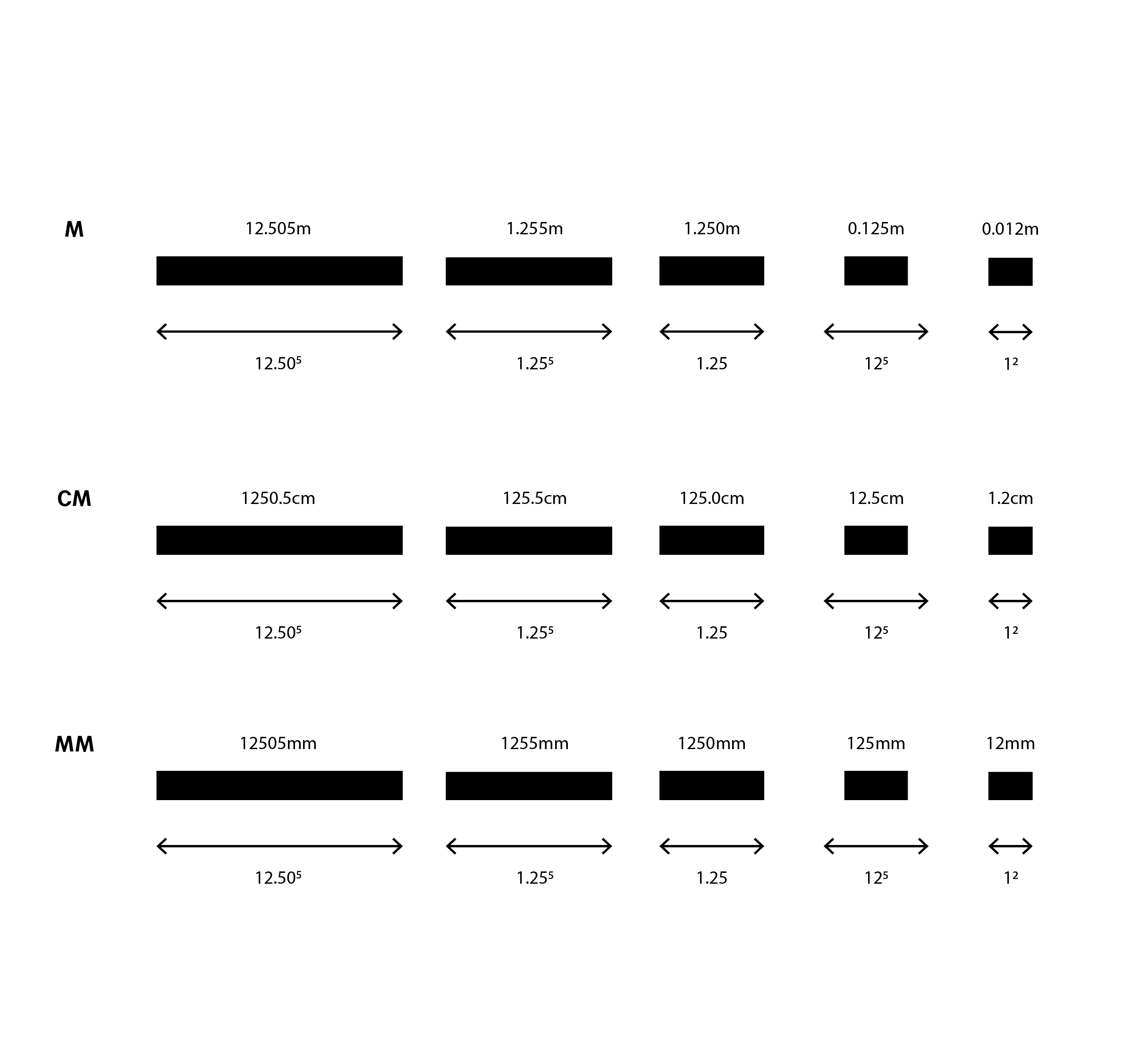

Architecture dimensioning in Switzerland follows the SIA norm. Typically, we can display these dimensions in commonly CAD software. Is there a way to do this in Rhino using the annotation style? Attached, you will find a plan with the dimensions and a summary regarding the display related to classical dimensioning in millimeters, centimeters, and meters.
To achieve this, it would be ideal to display decimal numbers as superscripts/exponents without a decimal separator. Additionally, having the option to use thousand and hundred separators as basic writing tools would be helpful. There have been past discussions on this topic that were left unanswered.
