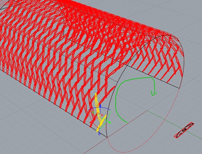

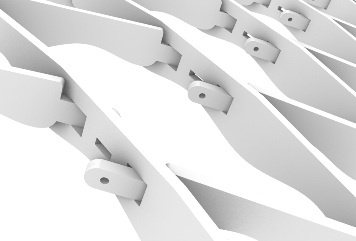

I’ve been working on this reciprocal structure script which will eventually be CNC milled. I’ve managed to get to a point where I’ve aesthetically achieved what I intended, however, it is not where it needs to be in terms of precision. The connections are sloppy are do not perfectly line up.

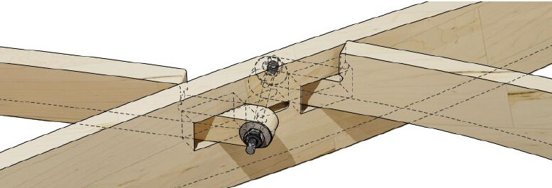

I intended on creating a connection similar to this:

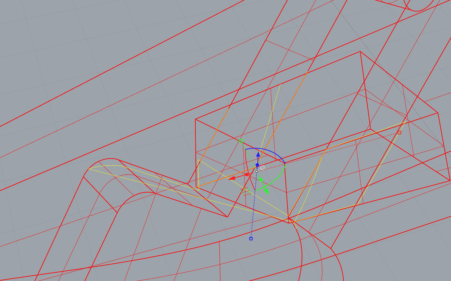

But have only been able to get to this point, which after milling some test pieces, do not line up well:
The structure is based on a 2D pattern mapped onto a barrel vault, which I used to create bounding boxes, to then map my modular piece into. The bounding boxes guided me in a general sense of how to map out the intersections and connections. However, has led to me slightly modifying the modular, little by little, with the intent of getting more and more precise. This has been tedious and would take far too long to actually get the precision I am looking for.

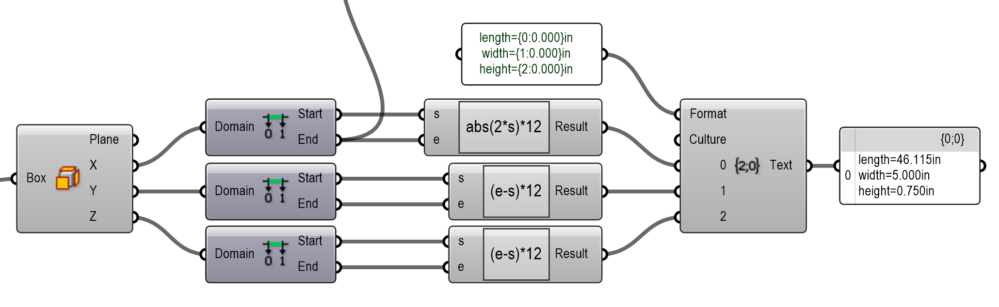

This is being built out of wood correct? Solid stock or plywood?
3 axis CNC or 5? The current joint suggests 3 axis.
Industrial CNC or hobbiest grade? The tolerances are very different between the two.
Are the dimensions I have below correct?
Hi Brad,
We intend on using 3/4" plywood.
We have a 3 Axis Industrial CNC.
The dimensions you have are relatively correct. We were aiming for 47" as this would minimize the waste on a sheet of plywood. When the 2D pattern mapped onto the barrel vault the linework shrunk a little. Ideally the individual members would be 47" x 5" x 3/4". Sacrificing an inch wouldn’t hurt, so either solution could work.

The joint looks more complicated than needed? What if you have one hole instead of three, with two ends overlapping without space between them? I guess you need to attach somehow to the piece that has the hole… :thinking: Thinking out loud.

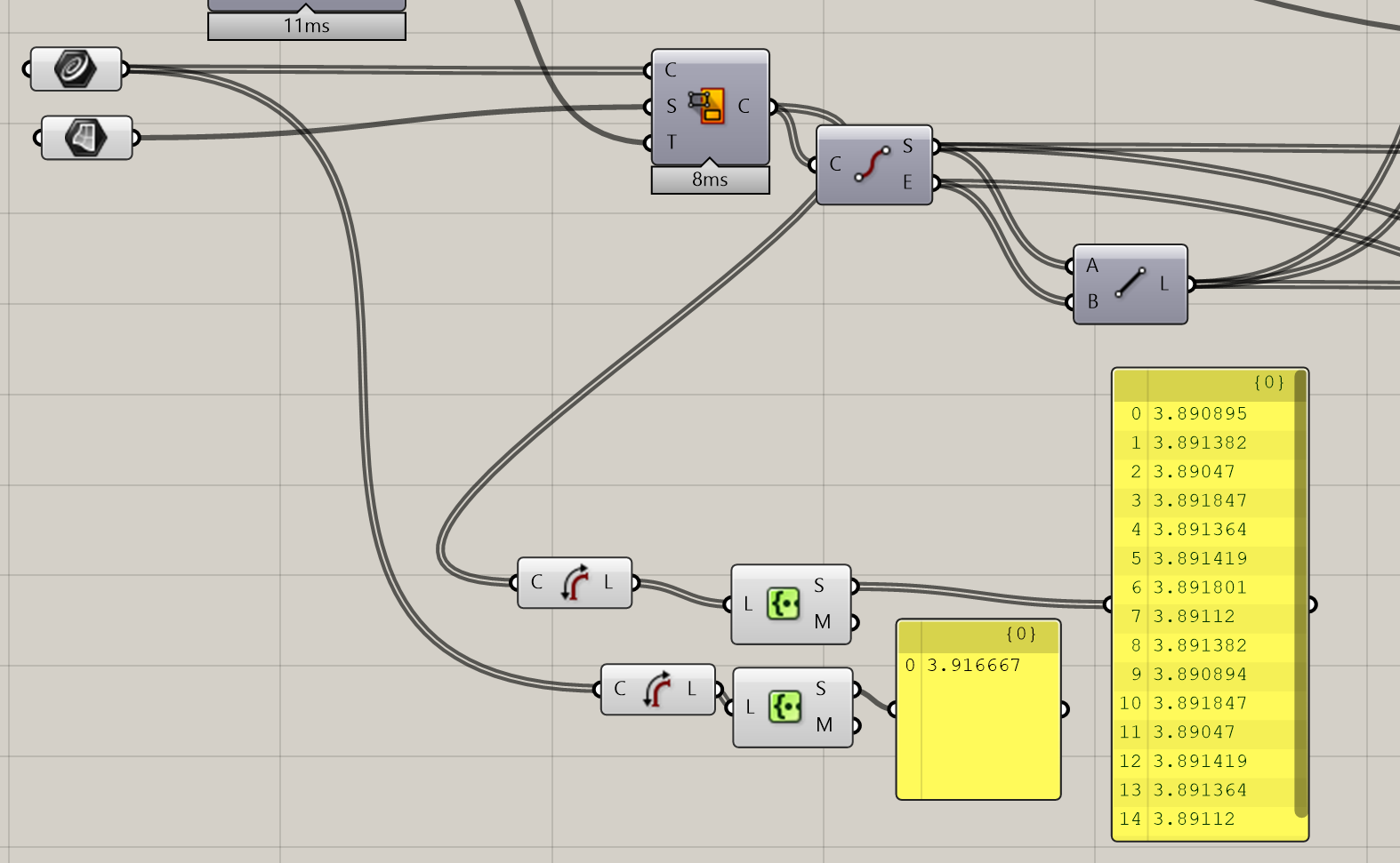

The lengths of the grid lines are uniform prior map to surface, but not after.
I don’t know what these are in imperial, but from 3.91 to 3.89 is a substantial difference.

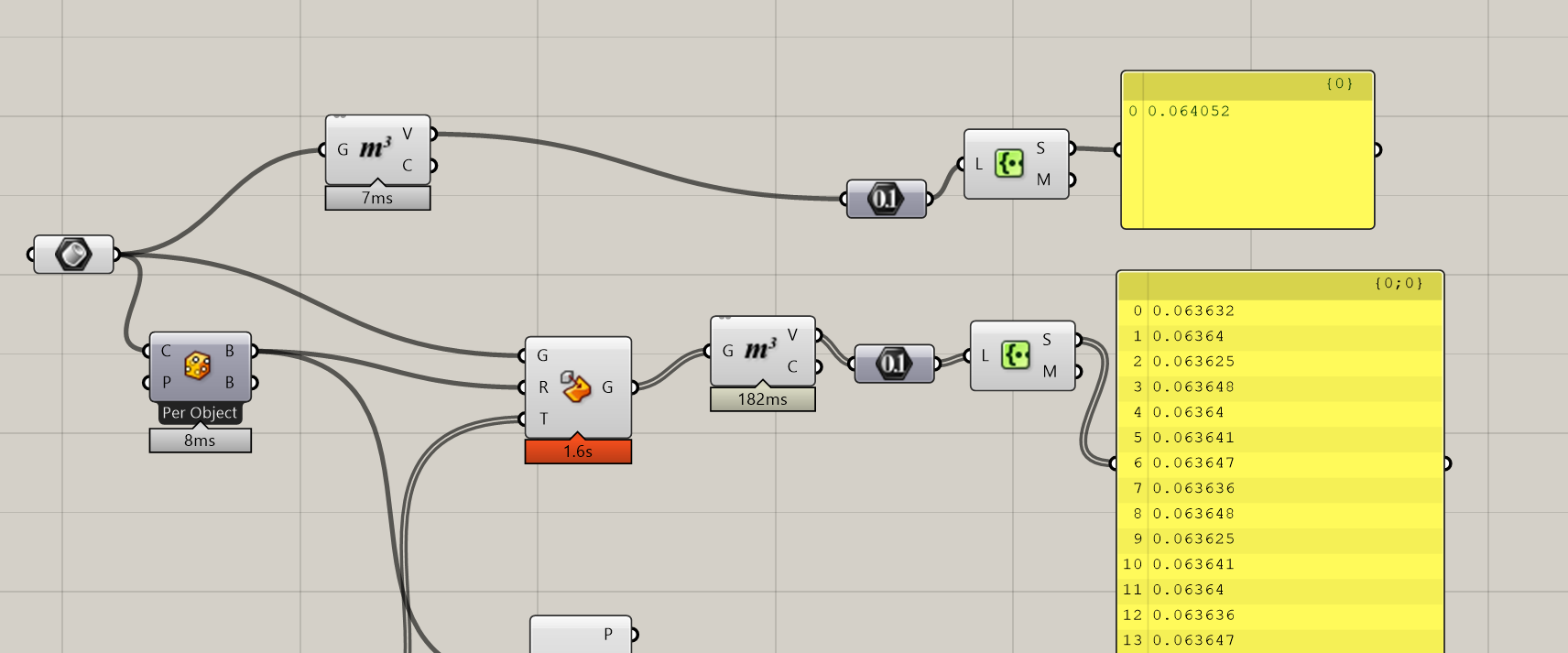

The second component you should never use in fabrication is Box Morph. Here, it is not that dangerous, as you are morphing from box to box, but you are once again introducing possible inaccuracy point to the system. The box morph should be replaced by orient, IMO. But here, luckily it does not play such a big part. There is slight volume difference here.
Given that the part you wish to fabricate is the same on all locations, I suggest that use a block as the starting piece. There is minimal risk in accidantally modifying the geometry.

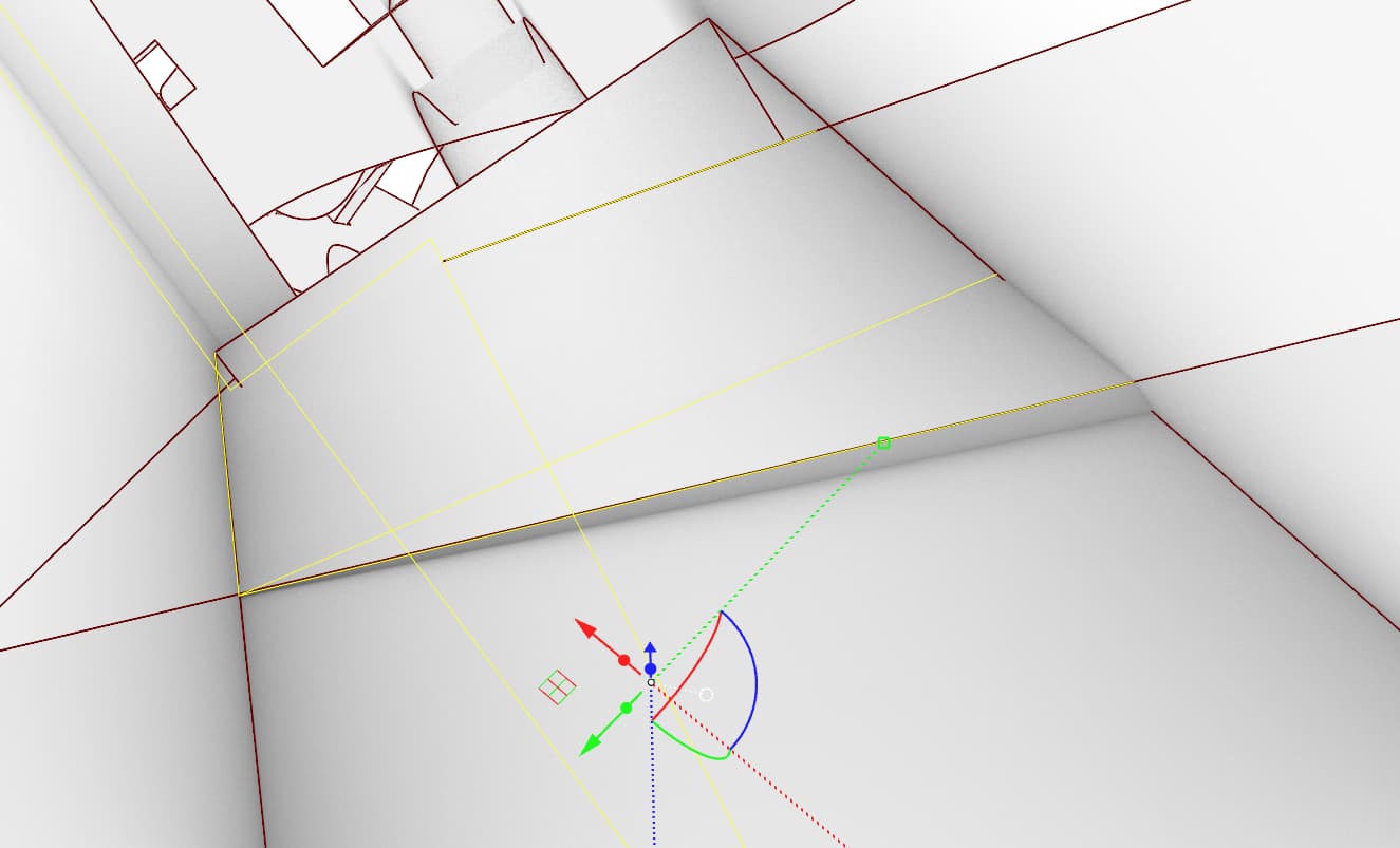

There is a large collision between the parts that could be fixed by widening the gap. I ran _intersect on two parts here.
Same view from inside the part.

One thing came to mind - as your shape is a perfect arc.
So all you need to solve is one intersection, and ArrayPolar the rest.

I liked the idea of the through-bolt, rather than a lap joint of some sort, as it would enable us to apply more tension to the joints as needed, and to evaluate how the structure would react.

I think for my case, I want to exist in-between the two extremes: tight tolerances will enable a more rigid form, however, for the sake of quick and simple assembly we want a little bit of play, and the through-bolt will enable us to tighten those joints as needed.

Have you accurately measured the actual material thickness with a micrometer, dial caliber or similar? How does the actual material thickness (not nominal or claimed by supplier thickness) compare to the thickness used in your model?
Hi David,
The actual material is about .704" whereas the 3D model is .750"
Yes, this is something I should have considered before hand but in theory I was testing the tolerances in the other directions and the thickness shouldn’t have that much of an effect. but worth changing while moving forward to make it more accurate.
Thanks!
.704 thick material in holes sized for .750 connections will result in sloppy connections.

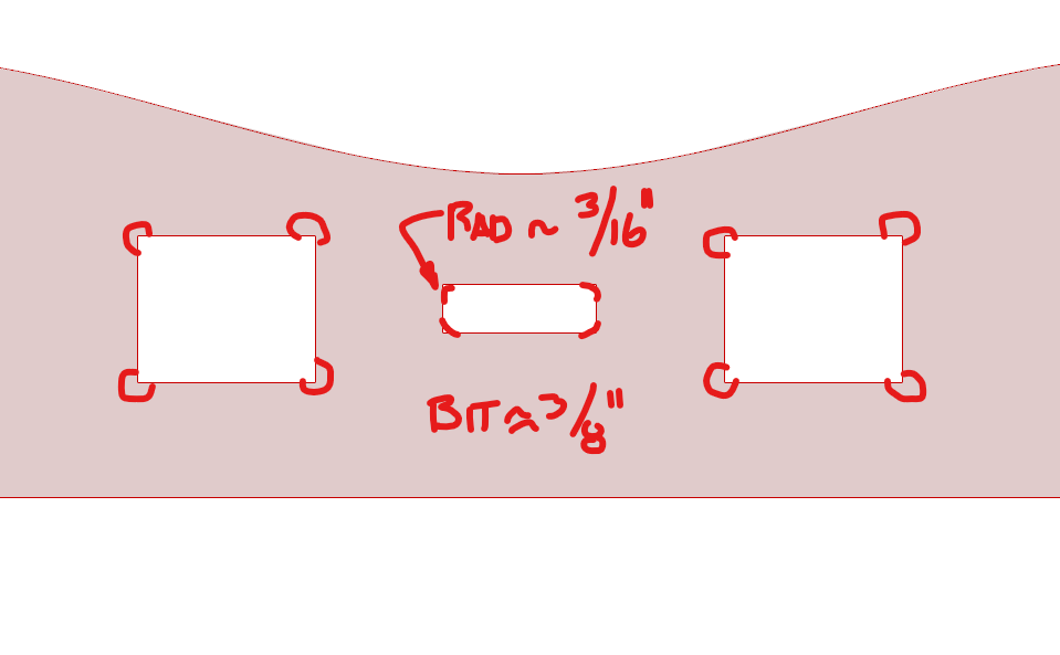

I would add the rads and dog bones into your model as well. I like my models to be as exact as possible so you can check things that might not be immediately obvious. I would expect at least a 3/8" diameter bit will be used. Maybe larger if cut speed important.
