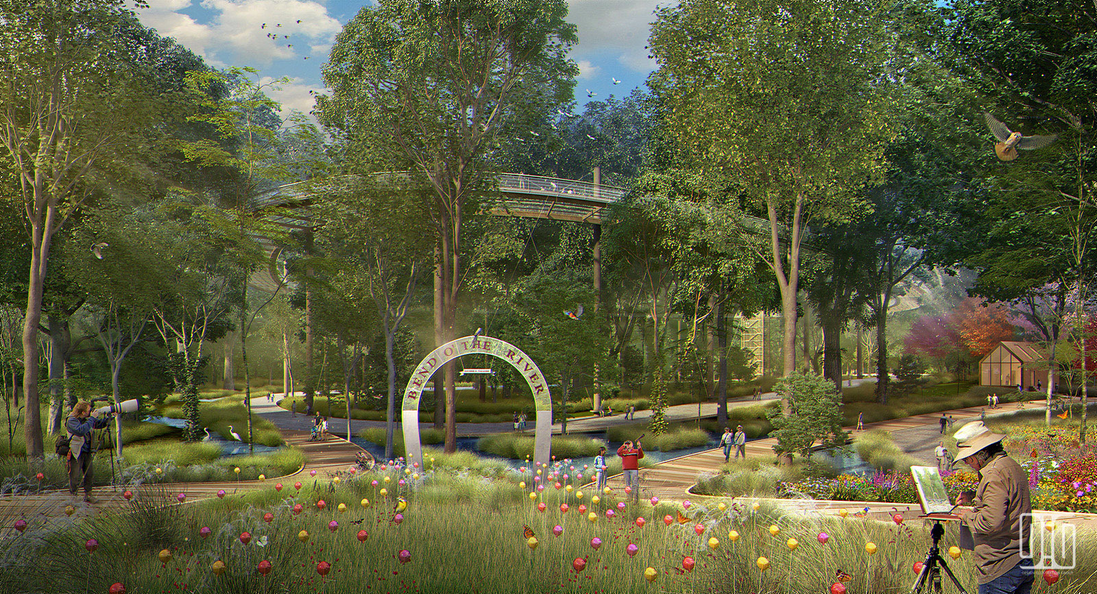

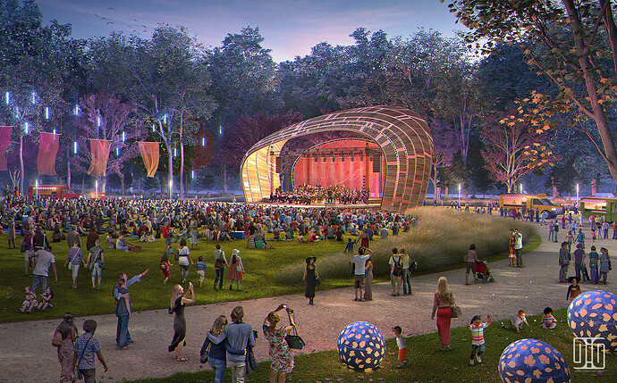

Hi All,
Here are the illustrations we recently completed for Botanical Garden master plan project, with a short ‘process breakdown’ video showing the Rhino model used behind one of the scenes. All composed, modeled and populated in Rhino (rendered in Vray for 3DSMax + Photoshop).

interesting how the different media are being mixed together in those very illustrative poetic renderings.
if i may say so you populated them very lively.
but one little thing i curiously have to point out which you have focused on with your camera movement is this cool bird hunter dude with the man sized tele lens, who seems to be standing on one leg while the 2nd one probably got abducted by the photoshop artist :smile: funny that you focus on that with the camera it seemed you even wanted to point that out purposely :slight_smile:
Hi Richard,
Thanks for the feedback. I did not look at the bird photographer as one-legged before (his foot is behind a fuzzy grass in the foreground) but now that you pointed that out he kind of looks like that :wink:
It looks better in a high-resolution uncompressed image…
The short video was not a final product, just something to quickly show the Rhino model components, other steps in the rendering process and the level of detail of the illustrations; that’s why it zooms in here and there.

Outstanding work!
Yeah, absolutely great stuff!
They have an oil-paintish, impressionistic, honest feel to them that I appreciate.

Great job.
the plants are 3ds max models?
I guess that apart from the stadium, the rest is done in max or post…isn’t it?
Hi Roland,
Thanks! Glad you and @Holo think these are more painting-like. I really appreciate the traditional architectural illustration and with computer rendered work I don’t think that photo-realism is always the best way to go, especially for exterior scenes. If you ‘entered the painting’ you probably would be a bit disappointed since we tend to model only what is necessary for the view and not much more. I’ll try to prepare something to show that. After all, each still image rendering is just a 2D projection of the 3D space, no matter how complex the scene is, and we need to worry only about what is visible (or few things outside the frame that would affect the visible parts like trees casting shadows from behind of objects visible in reflections).
We use various collections of people, usually the further away ones are low-poly 3D models that are rendered in (AXYZ people, etc.) and the closer ones are either custom-photos or collections like Epictor, VizPeople and Vishopper. But to make them blend with the rendering each needs to be tweaked to match the overall color scheme and lighting.
Plants are also a mix of various libraries but mostly Evermotion models. These are very heavy but we use Vray proxies for that. @Pitti, All scenes (except for 2D photo people) are populated with entourage inside Rhino - most of the models are Vray proxies that are made into simplified Rhino blocks but eventually rendered in detail in MAX. I found this to be most efficient since the entourage interacts with main model parts that are all created and updated in Rhino.
