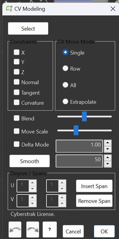

I have running Rhino 8 on Windows 11 in dark mode.
Unfortunately some GUI widgets are looking strange, displayed in wrong colors for dark mode. Especially texts on group boxes (black on dark grey) and text on some buttons (bright on white, CRhinoUiOptionsListCtrlPushButton). See images below. My questions are:
  • Can I programatically (C++) find out, if Rhino is currently in dark mode?
  • Do you have any suggestion for setting the appearance globally for all GUI objects of a type (like group box)?
  • Or do I need to address this problem individually on each dialog?

My problem is concerning the group box texts. When I toggle Rhino to dark mode, some dialogs appear with white, some with dark text color. Maybe it depends, if OnInitDialog() was called already, when the mode was changed.
With Dales latest changes I can now find out, that Rhino runs in dark mode. Then I tried to find a way to change the text color of my group box text. Unfortunately all my goup boxes are created using the MFC resource editor (I know, this is a very old legacy kind way of doing it…).
So they are just accessible as CButton via getDlgItem(IDC_MY_GROUPBOX). Is there any other idea to influence the text color?
One addition: I also tried to implement OnCtlColor();
I was successfully able to influence some colors (as CStatic label colors). But the whole dialog is ignoring Rhino’s dark mode setting, the dialog appears in bright mode and it looks that I have to configure now the complete dialog appearance.
OK, I tried it and can configure statics, edit fields, dialog background etc. But I did not find any way to change group box label colors…

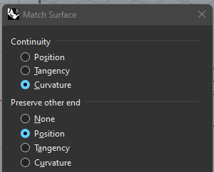

Hi @Peter_Salzman,
I don’t believe group boxes can be owner drawn. And since tabbed dockbars are not receiving WM_CTLCOLOR messages, I think the best approach is to create a new static control that draws like a group box. This instead of using a button with the BS_GROUPBOX style.
Our CRhinoUiSeparator is a good start on this.
The Continuity and Preserve other ends labels are CRhinoUiSeparator controls. It wouldn’t take much to draw a line around the bounding rectangle.
I’ll add it to my pile.
– Dale

For now I used a quick & dirty solution (removed all texts from the group boxes and added static texts which work OK):
