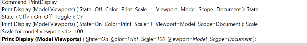

One question still, why the command “printdisplay” doesn’t have the same sticky behavior. All the time I reopen my file, I have to re-enable printdisplay state on and switch it to scale 100.
Wim suggested a macro here , but it complexify the thing.
Regards,
CC
Yeah, not all the Rhino command-line options are ‘sticky’. What you can do is create that macro with the correct options for you and put the macro in your startup commands. Then when you run Rhino it will automatically be set to your specs.
