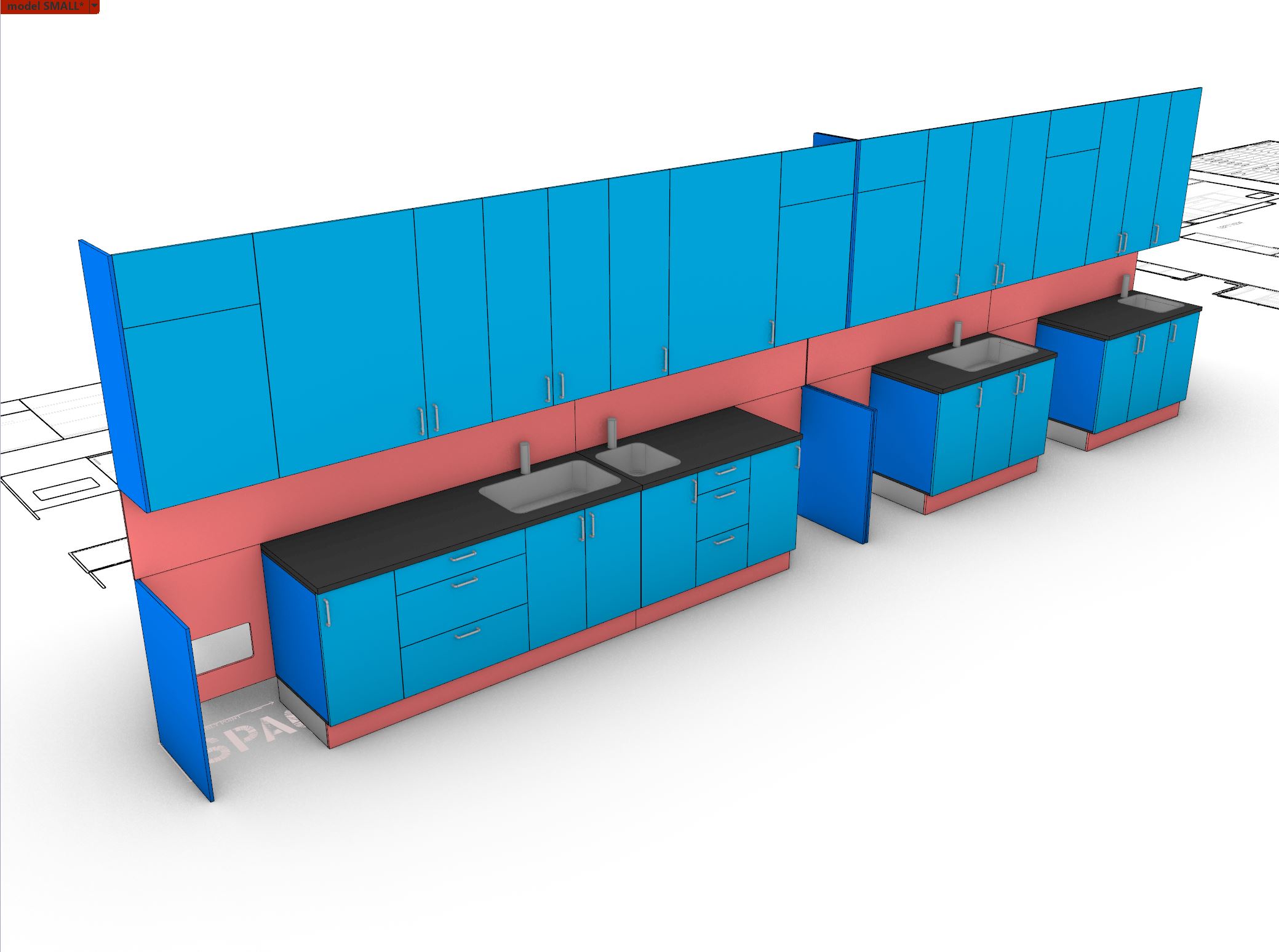

I have made a script that creates assemblies from various kitchen units.
It is adjustable in width and height using planes as slicers.
It is using the method you described: it slices with planes, creates sections (curves), then extrudes by desired distance then joins corresponding elements without loosing layers and materials.
The problem you having is that slicing creates the data tree that is hard to use to join the previous, the extruded and the following elements. I have found the method (a wild one).
