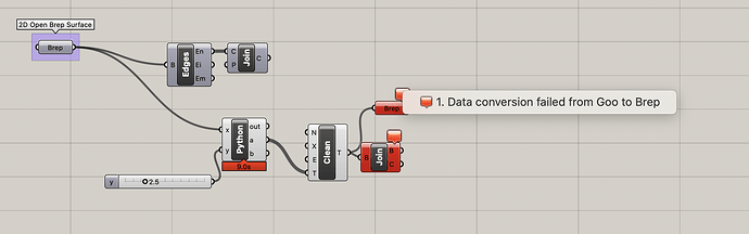

Data conversion failed from Goo to Brep
I am trying to use RhinoCommon to offset my brep using the Brep.CreateOffsetBrep in python. I get an output of Rhino.Geometry.Brep but I cannot use it in my grasshopper document. I need to use RhinoCommon because there is no offsetBrep command in rhinoscriptsyntax (only offsetSrf which will not work). So how do I convert the Goo to Brep?OffsetProblem.gh (308.4 KB)
import scriptcontext as sc
import Rhino
from Grasshopper.Kernel import *
import Grasshopper
surface = rs.coercebrep(x)
a = Rhino.Geometry.Brep.CreateOffsetBrep(surface,y,1,0,0)
b = []
for item in a:
    z = Grasshopper.Kernel.Types.GH_Brep()
    GH_Convert.ToGHBrep(item,GH_Conversion.Both,z)
    b.append(z)
the problem is that a is an empty brep meaning your createoffsetbrep failed.
