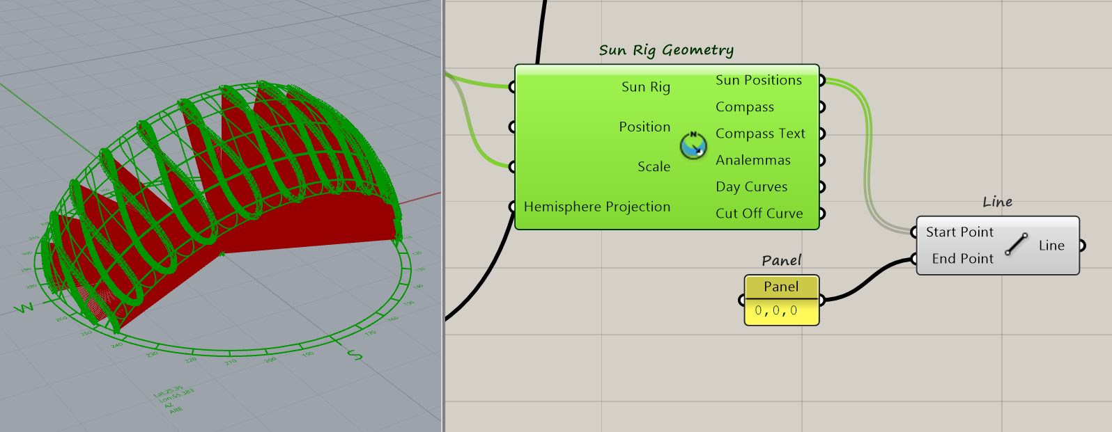

May I know if i create a line from the Sun Rig Sun Positions to the center position of the Sun Rig will give me an accurate real-life Vector from the Sun?

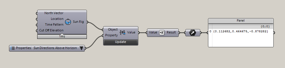

That is correct yes. You could also use the get property value component and retrieve the sun directions straight from the sun rig like below.
