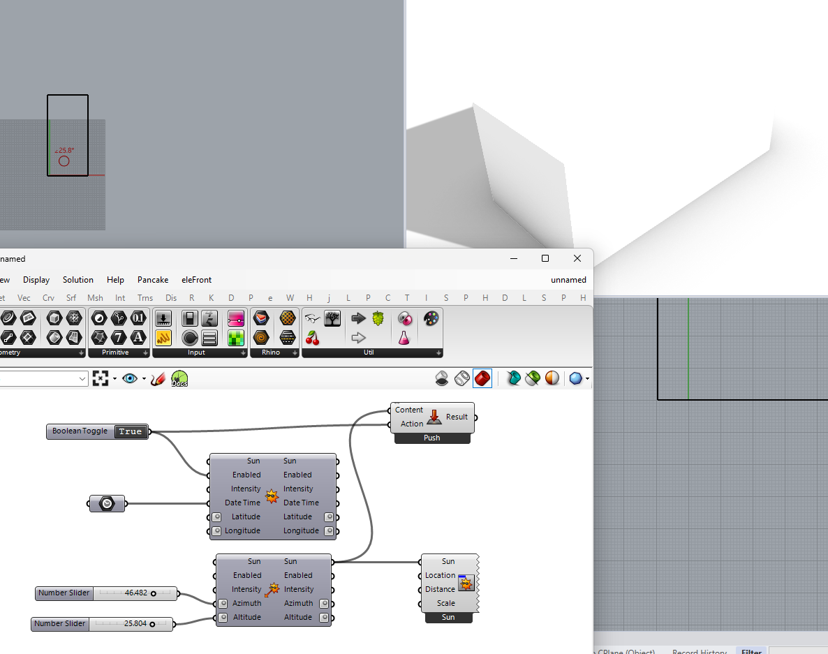

There is a component also in Grasshopper in Rhino 8 that also deal with the sun, its position and its path.
Thank you for the reminder. I had heard about this before but forgot about it. And thanks for sharing the screenshot. Helps a lot.
