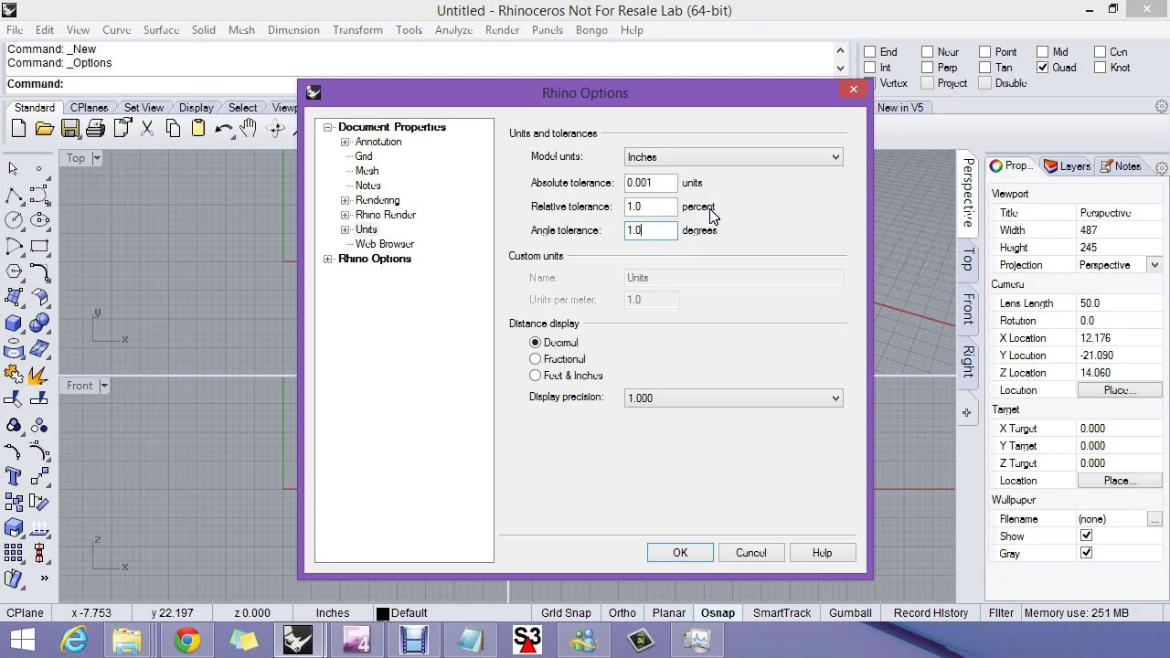

When I set the tolerance to say 0.001, does that mean rhino just handels a gap smaller than that as no gap? Does the set tolerance influence the precision of the calculations rhino performs, and can you tell me what the internal precision is?

Non-Uniform Rational B-Splines are the basic form used in Rhino and other free-form modeling software to represent curves and surfaces. One of the shortcomings of NURBS is the intersection of two NURBS surfaces is not exactly a NURBS curve except in special situations. The result of Crv2View is equivalent to the intersection of two extruded surfaces. However the exact curve can be represented within any non-zero tolerance by a NURBS curve, but with increasing accuracy requiring additional control points.
The absolute tolerance is used by Rhino in several ways. One is the decision of how many control points to use when a curve cannot be represented exactly. The number of control points will be increased until the NURBS curve is within the tolerance of the exact curve. Another use of absolute tolerance is deciding if the edges of two curves are close enough. If the edges are within twice the absolute tolerance Rhino considers the edges as coincident.
The absolute tolerance does not affect the precision of the arithmetic used in Rhino.
