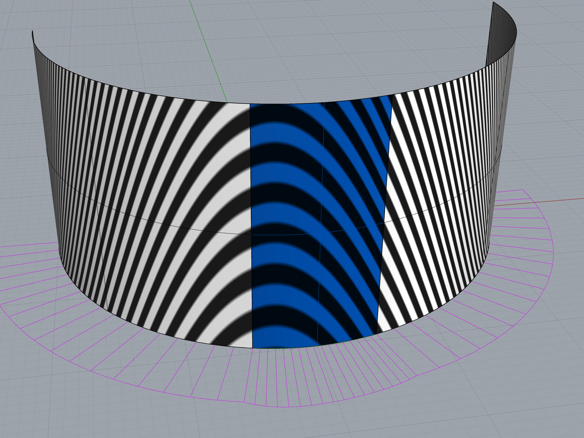

i try to comment with a craftsman’s attitude / beyond any math - and it s just a rough idea - happy to discuss:
I would love to have a absolute value-pair:
a diagnostic setting “bricolage rail distance”
and a resulting “sandpaper-post-production” distance / thickness:
failed G1,G2 seam
the following surfaces seam is of by 2 degree and the radius is of by 10%
(Radius 20 and 22mm)
failed for a typical class A surface.
(and the 2 degree will be visible on a glossy/polished part for sure)
sandpaper
but now, if i grab my sandpaper and allow a 10mm section (“bricolage rail distance”) (blue) to work over the surface, i have to “grind” 0.035 mm (“sandpaper postproduction thickness”).
0.035 is less then half the thickness of a 80g paper, or 1/10 to 1/5 of a typical coating / paint. My guess: for many applications this is still an acceptable result.
This 0.035 will say: the ideal surface is 0.035mm away - and maybe this is much easier to understand / read for most users ?
not as a replacement, but maybe as an addition ?
… my 2 cents - kind regards -tom

for mold making and surface finishing there is a lot of processes where you apply a layer of color / ink and sand or press … the first picture shows “tuschierfarbe” of injection molding part.
block sanding and using a coat guide …
cad-ish
at a point of the edge
intersect perpendicular to the edge (used a disk hier with d = 10)
result is a red kinked curve (red)
build a inner blendCrv G2-G2 and distribute the CV’s to have nice flow ( see curvaturegraph)
meassure curve deviation between both curves
along an edge
yes - the transition surface is needed:
a simple pipetrim with blendsurface and (oldschool / outdated, missing nice rainbow) PointDeviation
… it s just an idea
for most people it s hard to judge a 1%, 5% or 10% curvature deviation..
you need to sand / or to fill 0.01 mm on a 10mm wide stripe seams more hands on…
At my company I’ve got a guy named Yuri — he’s my G2 continuity between imperfect surfaces. He turns every 3D model made by clients into silky-smooth geometry. Honestly, a master of sanding. I call him the human version of Rhinoceros3D software,
Then we need to do something about visualizing that in examples. I am sure that every industry has its own specifics for what is considered good enough. When matching for G2 continuity, first of all there needs to be a reasonable G1 match before you even can look at G2.
either manually constructing it, or in code. What you are suggesting is that the software creates a virtual pipe trim and blend surface and then measures the distance between that surface and the edge.
I don’t know how feasible this.
