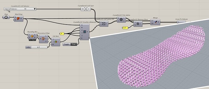

I created a lattice inside a volume, but i’m not happy with the “hanging curves” who didn’t create a proper geometry. Any idea how to fix this ? You can see in the image below that the end curves are just hanging without forming a dodecahedron.
Mcneel forum.gh (709.2 KB)
Someone ?
Crystallon trim lattice has two outputs. Look at the lower one.
Any idea how i could create a lattice structure inside this volume ? Nothing really works, i have tried Crystallon and intrallatice … I get nothin clean.
Mcneel 2.gh (553.6 KB)
FYI,
CrystallonDemo.gh (410.5 KB)

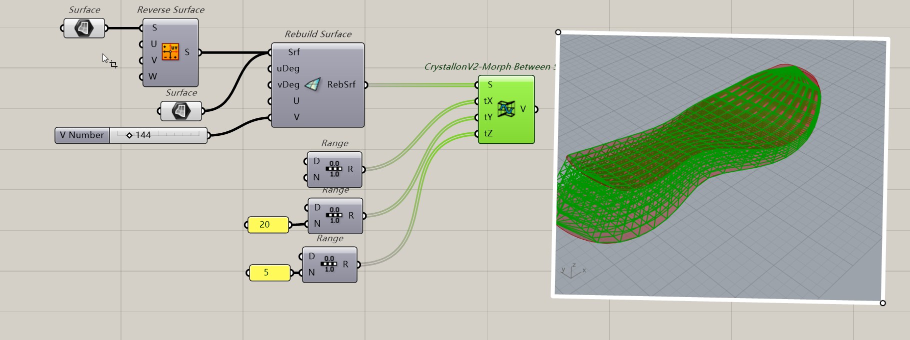

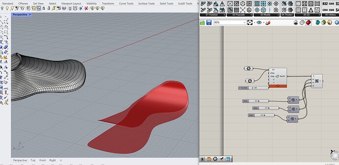

This is almost it, but you can see there are still some floating curves on the left and right side. The volumus is actually going to dissapear, and there will only bee a surface above and bellow the lattice to create a support for the ground and the foot. The best way to do this would be lattice between surfaces, but somehow i didn’t manage to do it since rhino did not recognize the surfaces. And for mehses, they need to have the same topology …
Here you can see 2 surfaces, but nothing happens between them, no lattice.
Mcneel 3.gh (124.5 KB)
FYI,
CrystallonDemo2.gh (63.7 KB)
