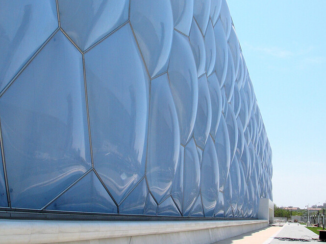

16watercube
The similar topic was posted here but I want to go further on the one discussed
