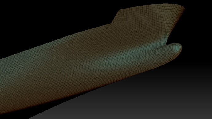

  1. ctrl-c ctrl-v from Rhino to MoI
  2. meshing in MoI (I prefer mesher from MoI3d)
  3. decimation in Zbrush
  4. polygrouping in Zbrush
  5. Zremesher in Zbrush (I like zremesher in Zbrush but Rhino also has it)
It’s still not perfect but after adding extra loops on the hard corners it will be enough for subd smoothing. After that, you will have a perfect smooth render or 3d print (after freezing and decimating). I am writing about that because only after decimating lights/shadows looked ugly. Best would be manual polygonal retopo what on that model won`t be so hard in Modo/Blender.
That zremeshed obj may be changed into NURBS once again (subd->nurbs in MoI3d in my case but possible also in Rhino):
meshing_test_moi3d.obj (2.7 MB)

@mdesign Thanks a lot. I can use this mesh as well after some more processing.
