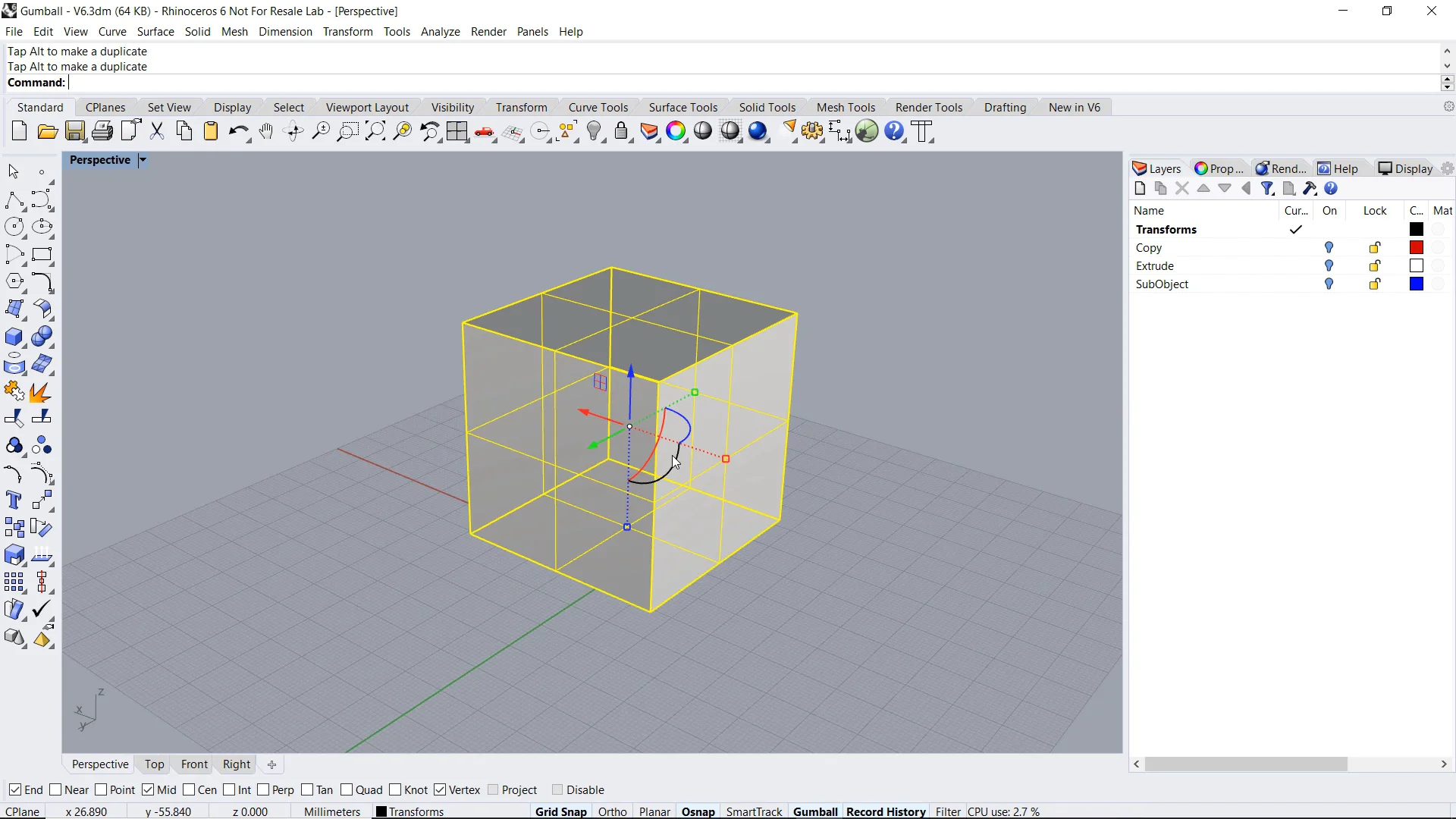

I’ve got an object and I want to move a copy of it 42". I tried copy/ paste (in place) and then with gumball I move it 42" but is there a way to skip the copy/paste? --Because it takes quite a while for paste to happen. Is there a way to do it with gumball?

Yes. Alt with Gumball will make a copy.
Either:
Click on an arrow with Alt held down then type the value in the box - it will make a copy and move it that value
or,
Start dragging and hit Alt once to see the little “+” sign show up - then drop the copy where you want. Sometimes you have to hit Alt a few times to see the “+” sign - Rhin “bug”…
HTH, --Mitch
Start dragging the selection via the Gumball. Then type 42 and press enter to limit the distance. At this point tap the Alt key and you’ll see a + symbol indicating that a copy will be made after placing the selection.

Thank you all. This is perfect.
