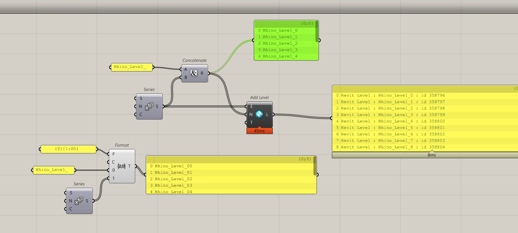

i’ve some issues creating the levels in revit from grasshopper.
The values seems to be right but the output is wrong. Attached the picture.
What I’ve to change to make it work ?
Thanks in advance !
Thanks in advance !
Looks like you need to name the additional levels as well.
Here i use two methods, the Concatenate component or the more advanced Format component.
Great, worked out. Thank you !
