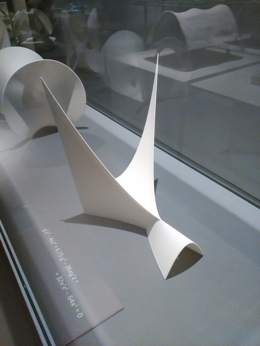

I am a beginner with Rhino and Grasshopper. Some years ago I went to an exhibition (can’t remember what was about, nor who the author was), this exhibition had on display, various models that were generated from mathematic equations. I only took this two photographs, one i was lucky to include the equation.
So, how do I even start to model this one with Rhino? I guess I must use Grasshopper.
I also believe that the model is composed of two intersecting parts, hence the break in the equation. I wasn’t that great with mathematics, but I can see it’s composed with parabolic equations, giving the U shapes, I just don’t understand how the cubic exponent influences the model.
Thank you.
I want to learn how to make other model from equations so I am grateful if you provide links or tutorials on how to start with the basics.
(y^2)(z^3) - 4xz^4 + 6.75y^4 - (36xy^2)z +
+ (32x^2)(z^2) - 64x^3 = 0
(can’t type superscript numbers here so I hope I wrote it correctly. down below is a correct screenshot)

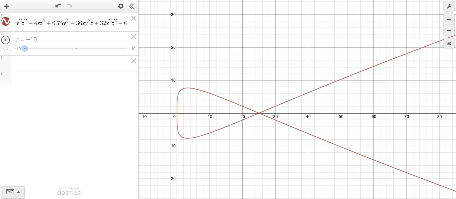

These are the graphs that are generated using desmos.com. Being z a variable, the graph changes accordingly.

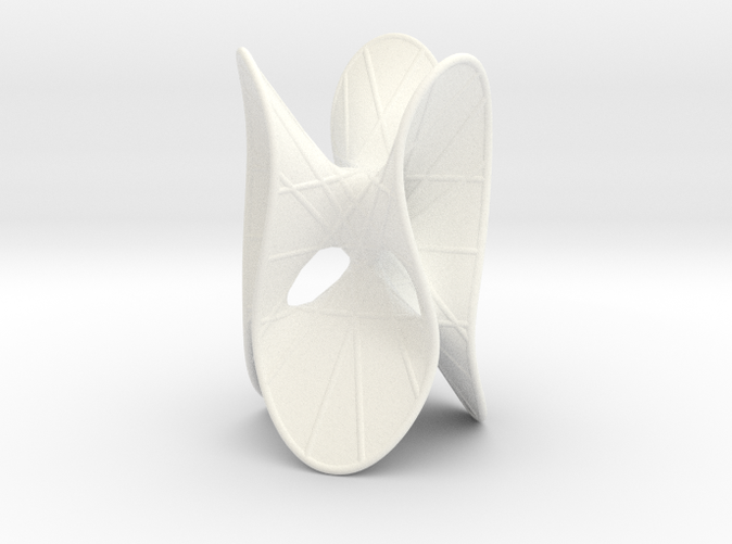

Meanwhile, I found the authors of those shapes, which are very interesting to take a look at. All shapes and model come from algebraic geometry like Kummer Surface, Togliatti Surface.

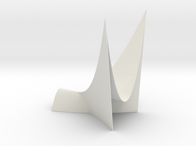

But I was, specifically, more interested in the Swallowtail surface, which can be seen in 3D here:
