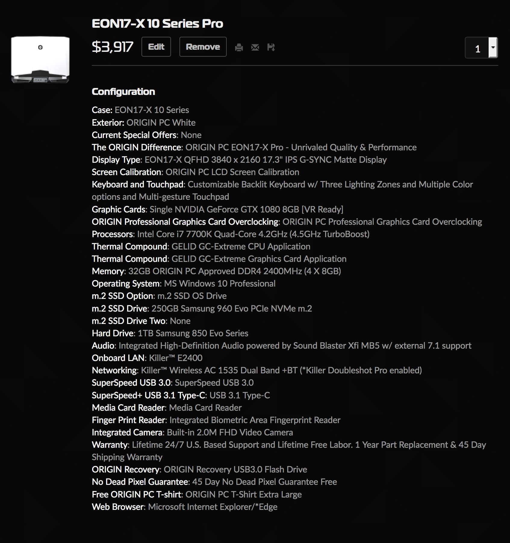

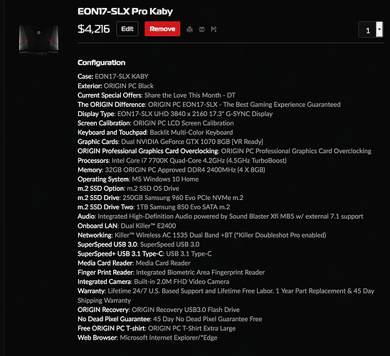

I’ve looked into a few new setups, and thinking this is good:
i7 7th Gen CPU • GTX 1080 GPU • 32G Ram • 250G (?) M.2 OS Drive • 1 TB Sata SSD for Drive #2.
These are a few of the contenders, and I’d really like to know:
  1. Am I spending way too much on this? (again Rhino+Vray setup) Suggestions on cheaper options to the ones I chose here?
  2. The Origin PC route is using Custom Builder in FL (I’m in CA) and they’re not a Manufacturer
  3. The MSI (love how silly flashy it is!) is a Manufacturer, and it’s cheaper, but the CPU isn’t NEARLY as good, it seems. And it doesn’t come with 2nd SSD instead of the HDD
Here are the grabs of the system builds (and FYI Boxx just too much for add-ons, and Dell just doesn’t have the hardware config, it seems!)

I would take 64GB RAM.
Often I parallel open complex models (different projects needs to be done without to open/close every time a client ask for a change), start Vray renderings and working on large images at Photoshop and I’m glad to keep all task open.
Also I would buy a PC so you can easier upgrade later. A good large 4k screen isn’t expensive and the work makes much more fun.
Things get much hotter inside a laptop, so rendering means your laptop is like cooking for hours…
I need a mobile workstation. It’s the reaon I’m going through figuring this out.
Thanks Micha for the suggestion of 64G ram.
And yes, I’m looking to configure the best PC laptop workstation I can, without paying additional for things that arent going to help, or aren’t really any better than the next option down.
