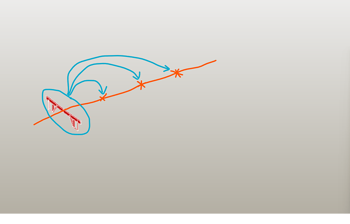

Hey Team,
Just wondering if its possibe to Place a Revit Model Group to set different locations.
Would be great to set a Group of Revit Locations, by search for Groups in the Revit model.
Then set the group to a plane/point locations

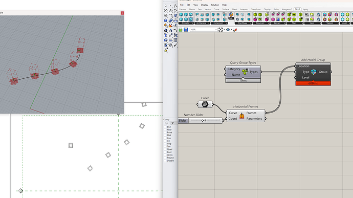

oh epic Japhy. Thanks Heaps
