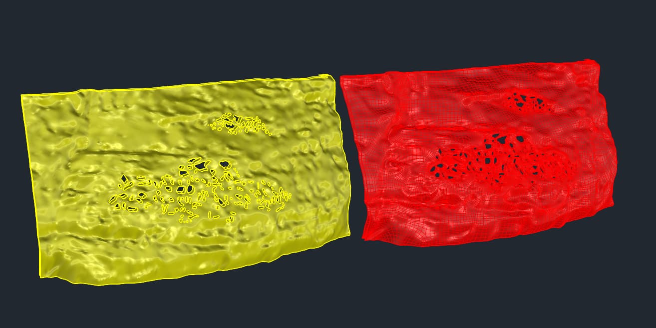

example 1, no acceptable at all :
The conversion (yellow = polysurface / red = sub d) above gives the desired design but creates geometries that are too thin.
example 2, a bit more acceptable :

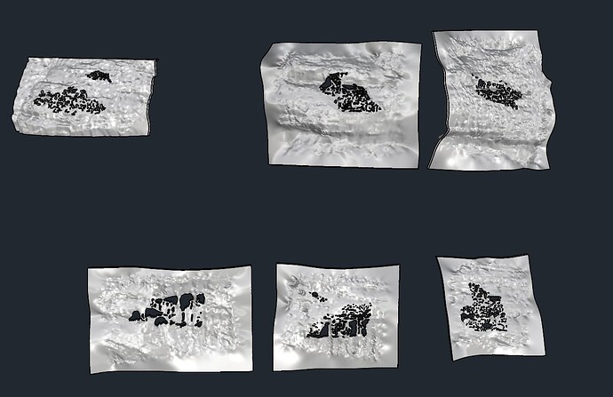

Attached below are the 3D file containing 6 polysurfaces to be converted into SubD.
3D - POLYSRF TO SUB D - 6.3dm (3.8 MB)
3D - POLYSRF TO SUB D - 5.3dm (3.5 MB)
3D - POLYSRF TO SUB D - 4.3dm (2.5 MB)
3D - POLYSRF TO SUB D - 3.3dm (2.8 MB)
3D - POLYSRF TO SUB D - 2.3dm (18.6 MB)
3D - POLYSRF TO SUB D - 1.3dm (2.8 MB)
That’s challenging… you have all objects as polysurfaces and all holes are vertical or in one direction?
can you do this as a single surface thickness subd to start and offset it after the conversion?
that’s my go to method for thin stuff.
you could also shrinkwrap this with a larger edge length.. and a higher smoothing value. that would help eliminate the thin bits. you could then quadremesh>tosubd>
can you machine a mesh? If so Shrinkwrap may be the way to go and end up with a mesh result instead of subd.
