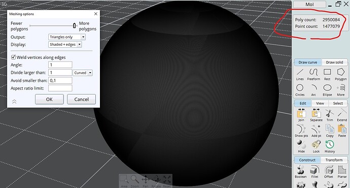

This is not the maximum resolution. I can get in MoI3d much denser export:

Here nigh 3 million faces for simple sphere, that is even smaller than what you have (21mm radius) in Rhino 7.
Mesh settings
Along the same method it is easy to get say 7,5 million polys for the same sphere
This probably is going to be limited by available RAM.

There isn’t really a cap other than probably what the OS allows you to allocate for memory. On my M1 that appears to be around the 7,75 million for the sphere, but I wouldn’t be surprised if that number were higher on machines with more memory and more swap. Also note that in the case of this smooth sphere that is 7,75 million quads
Note that this is for the meshing operation. Rhino can hold more than 7,75 million in a document even on my M1, obviously.
It probably needs a long time to recover from adding the object to the document, no doubt lots of swapping between disk and RAM going on, which can be a very, very slow process, especially on slower drives and with slow bus speeds. If you bump your swap file size you probably can do even larger meshes, but it’d take even longer to get added to the document.
