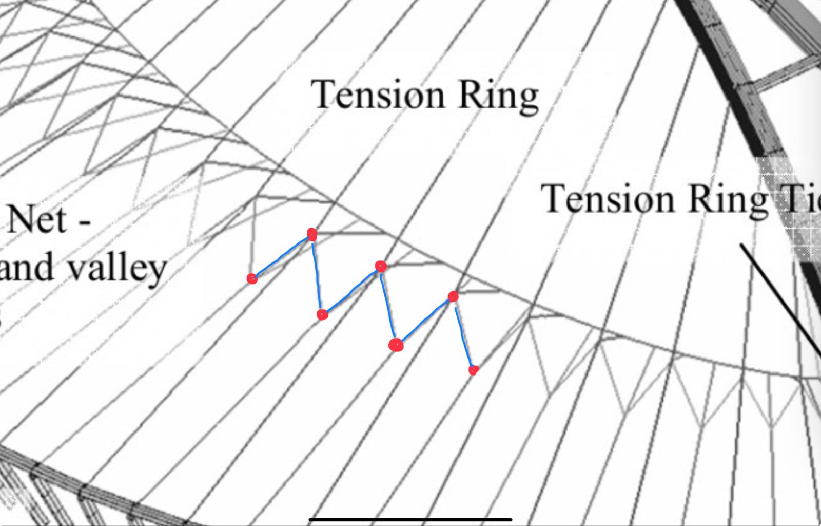

I am currently designing a stadium in grashopper and have come across the following problem. I want to connect two points from a large number of points arranged on a curve to the point on a curve above. there are also several points arranged on the curve above. one point should always be connected to the points below it that are arranged to the left and right of the point. so each point is always connected to two other points via a line (see picture of the static system). can anyone help me?
I could try to help, but unfortunately, your Grasshopper definition requires the use of plugins. It seems that all the Toro components create points that feed into a single point container. Could you not internalize this data for us?
Paula,
This is easy enough to do with the Relative Items component. However, for that to work, you must first make sure that the order of the points in the two lists run in a circle around the arena.
I did not know about the Sort Along Curve component, so I went farther back into the script to make sure the points were in order at creation. Thank you for this.
Thank you so much for your help Volker! I’m sorry that you had to deal with this messy file, I’m still at the very beginning as a user of grasshopper. Thank you!!
