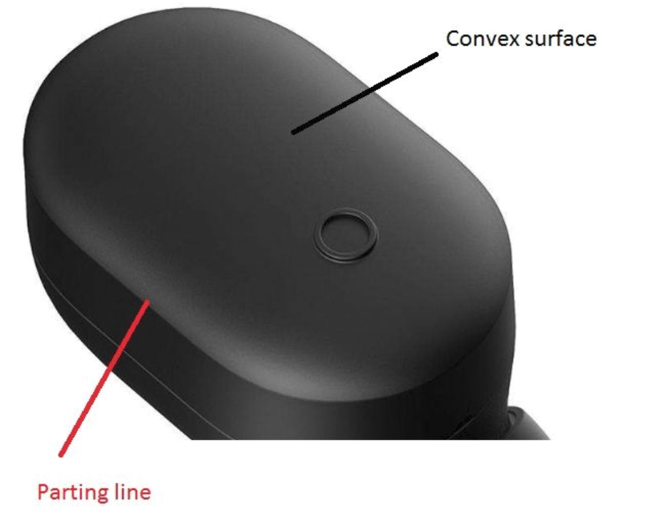

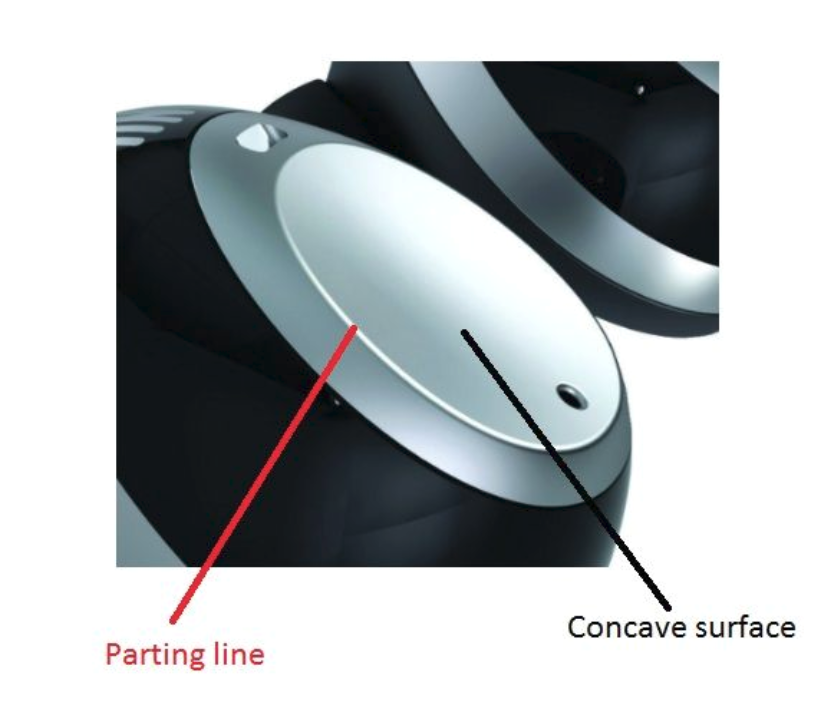

Hi ,
I would like to know what is the best way to create a convex / concave surface within a visible parting all around in Rhino as per example below :
Thanks.

Hi Jerman - by this do you mean that you are starting with a known parting line and you want to surface within it? The tools to use will vary with the situation, do you have a specific example?
A quick answer could be _RailRevolve in both examples.

as I said, you can use RailRevolve, NetwrokSrf or sweep by pairs, it depends on what do you want to do with those surfaces later.
