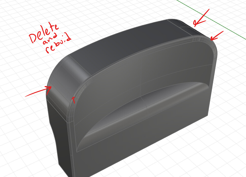

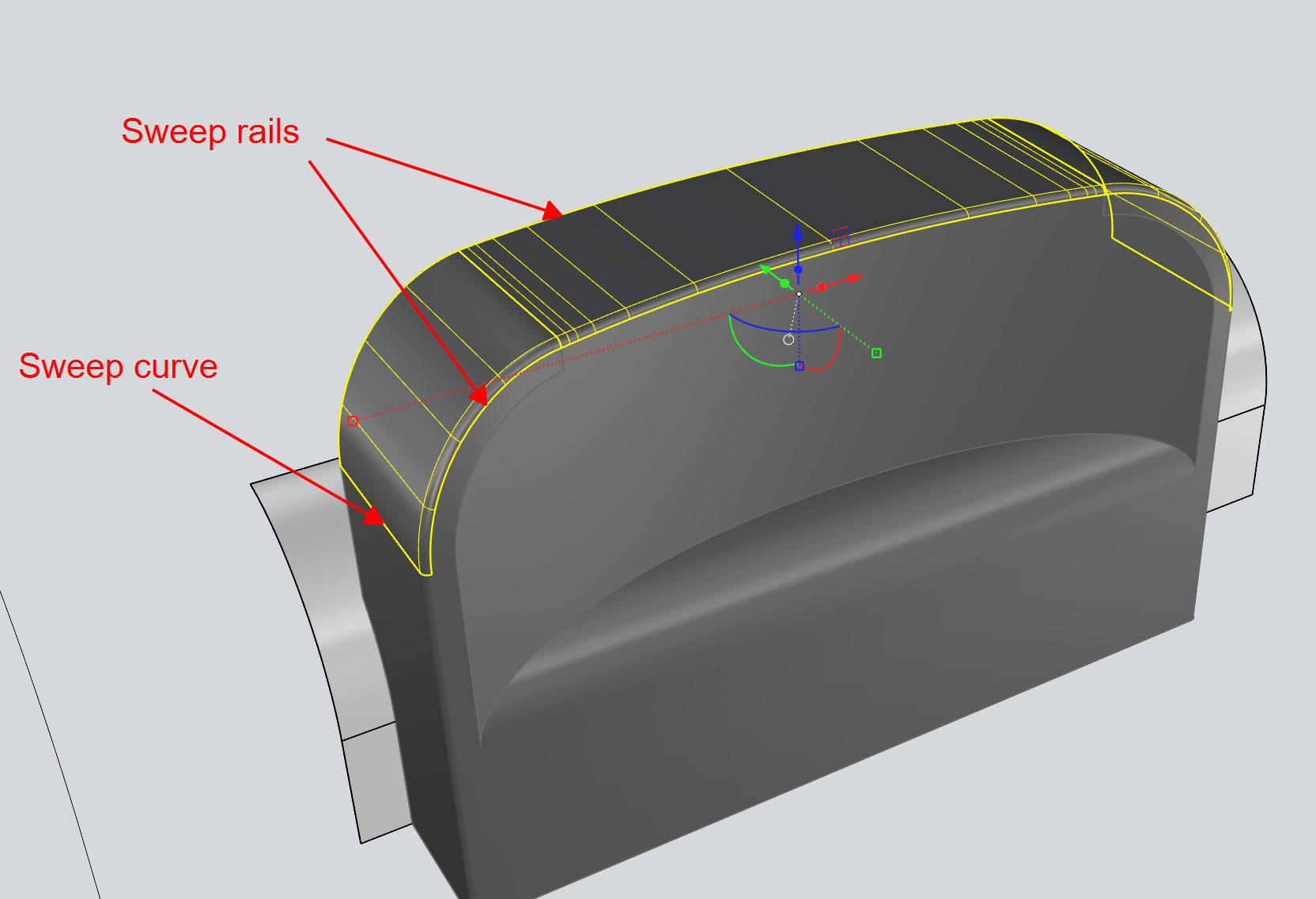

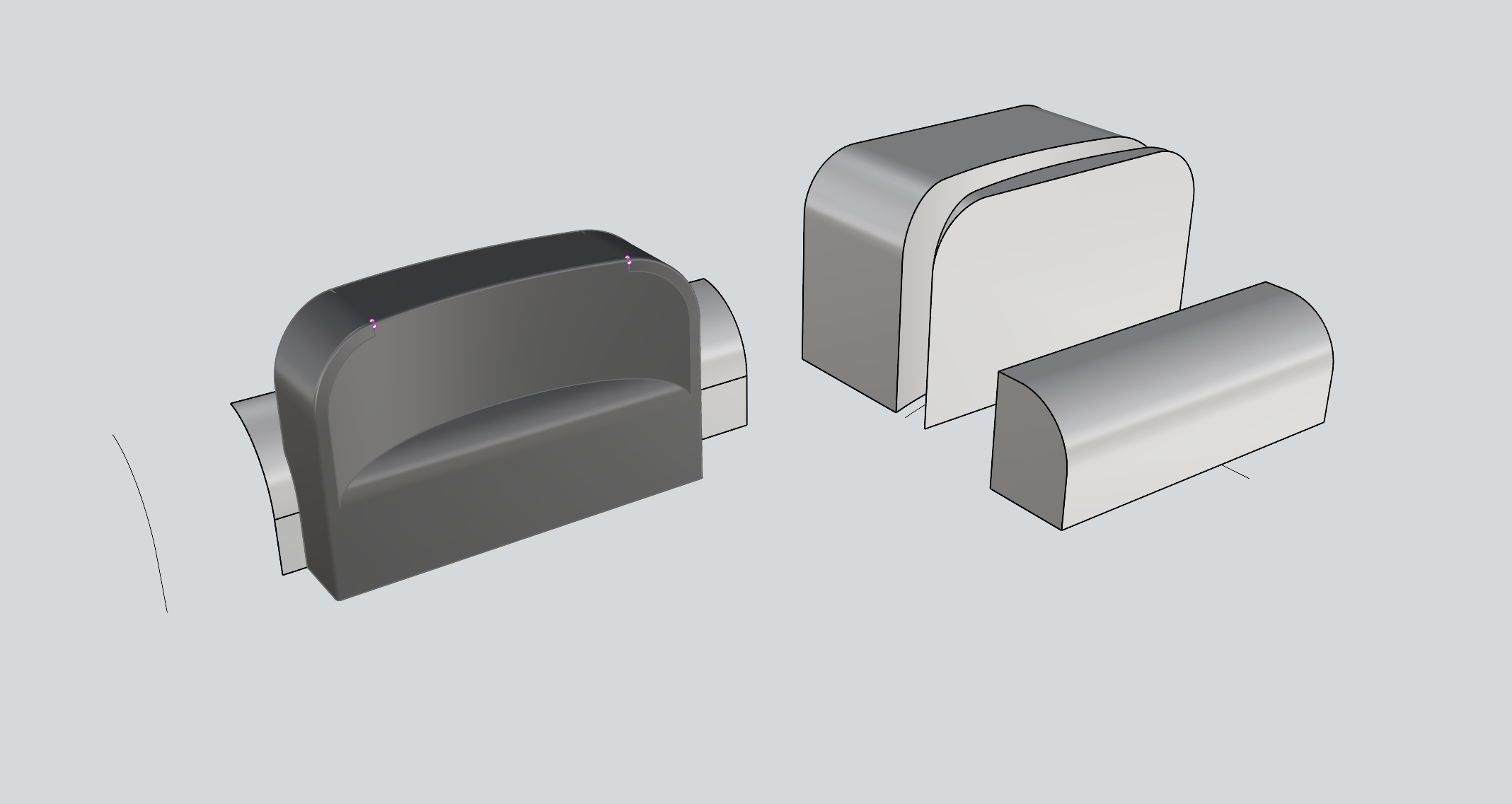

I’m trying to make this thumb tab. I’ve been at it for some time. I always end up with naked edges and fillets that won’t work. Obviously, my approach is erroneous giving me wonky geometry. The dark gray model is the best I’ve gotten so far. I left some parts that I used to boolean and cut in the hope they’ll explain my process.
Thumb_TAB.3dm (485.2 KB)
simply deleting and remaking the surfaces highlighted yields a closed polysrf for me.
this video may help-
Thanks Kyle. I deleted all the highlighted surfaces, duped the curves of the opening, then used sweep2 to sweep the marked edge and now it is valid. What I cannot understand is how this keep happening as I model. It is a small piece. Should absolute

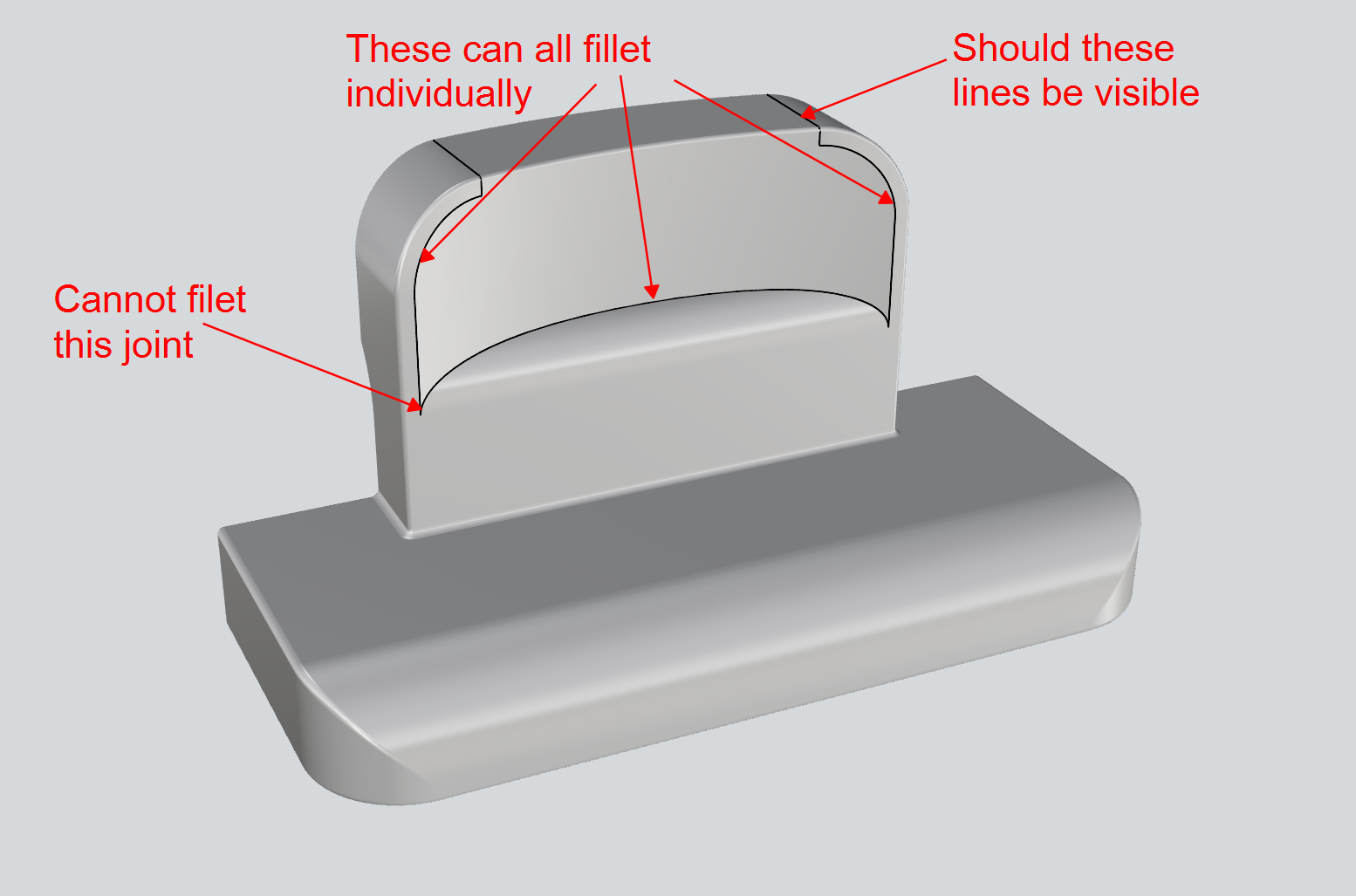

Kyle, I have watched your video before, and again today. My problem is I’m not understanding what modeling procedures I should be doing to reduce later problems. Especially at this scale. Most of my work has been architectural.
This is where I’ve reached with this piece. I cannot filet the joint marked. I don’t know what I should have done to make the edge joint so it would filet.
Thumb_TAB2.3dm (4.3 MB)
Try using simple unjoined curves, build simple surfaces, then intersect them, and finally do the G2 filleting (use Pipe to establish the trim boundaries, then insert BlendSrf or EdgeSrf with subsequent matching). You have a classic “Y” fillet corner. I did half of it, so you have something to experiment with ; )
