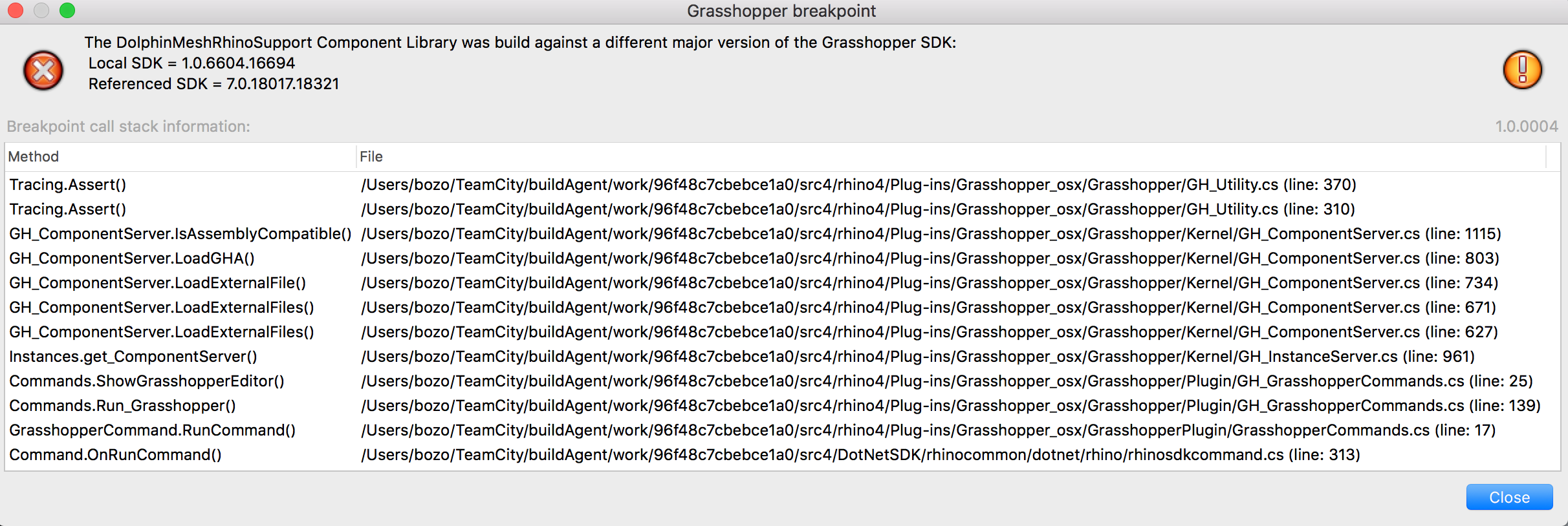

Component library was build against a different major version of the Grasshopper SDK
grasshopper
#1
I have installed RhinoCommon and Grasshopper on MAC using the NuGet packages
as described in:
I would like to use these instead of the standard templates because we are working
with multiple developers on this project.
However, I have the following error when starting grasshopper and my components
are not loaded. Any ideas how to solve this?
(Steve Baer) #2
That guide is for Rhino 6. Make sure to use the Rhino 5 version of the guide since Mac is a V5 product.
#3
Thanks Steve.
There is a " Step-by-Step (Mac)" discussion in the V6 documentation. Is that an error?
(Steve Baer) #4
Probably an error as of today since there is no V6 WIP of Mac available yet.
#5
Ok. Thanks.
