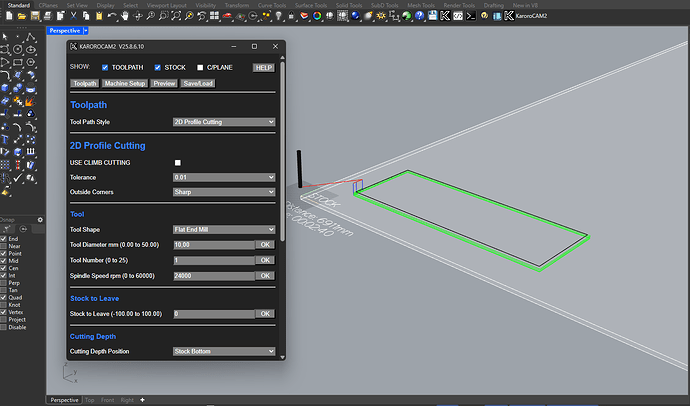

A quick update: using RH8.16 to compile .gh into RHP I am still having issues with CustomPreview and/or not seeing the compiled GUI. Here is the deal:
A1) With “Keep open after command completes” & using Custom Preview component to preview geometry, the compiled RHP preview remains active permanently (even after using other commands).
A2) With “Keep open after command completes” & Content Cache to preview object works as expected and GUI stays active.
B) Without “Keep open after command completes” & using Custom Preview component to preview geometry, the RHP GUI flashes for a second and then disappears.
I can see the regression in A1. Something changes in GH1 behaviour. I will look into this. A2 and B are expected behaviour.
