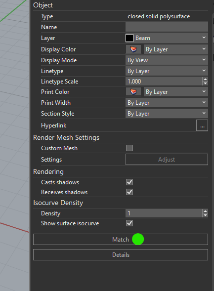

To match a surface material or color you can use the Match command/button.
https://docs.mcneel.com/rhino/8/help/en-us/index.htm#commands/matchproperties.htm
