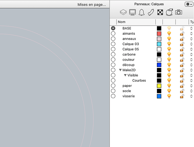

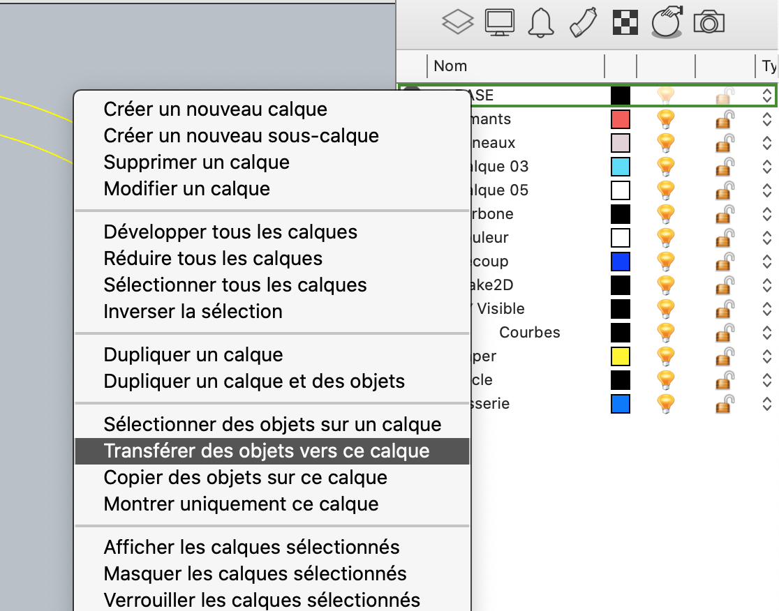

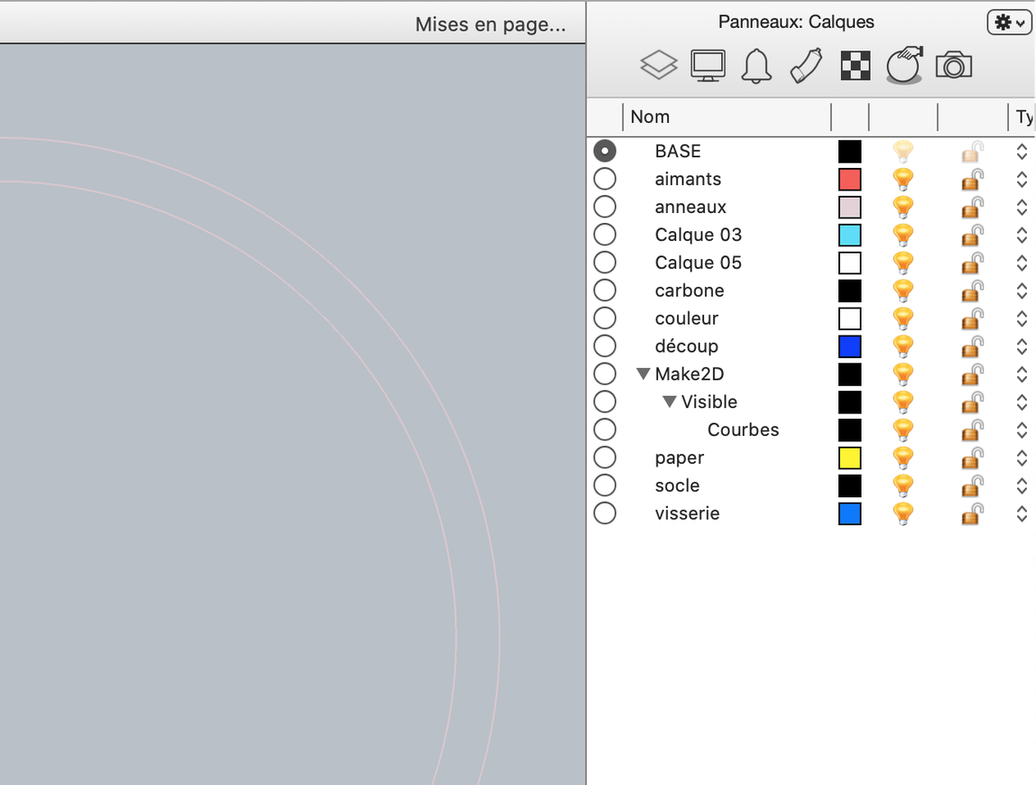

I don’t know if it’s me or what, but objects are not changing their color when I change their layers …
And it’s like … really annoying
btw I’m using Rhino 6
Thanks

The color is probably assigned by object, not by layer. Select the object(s) and in the Properties panel, change the color to “by Layer”
It worked, thanks !
