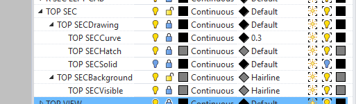

Does anyone know if there is a way to set the default settings of clipping drawings? Right now I have to manually change the color, print width, etc of each sublayer of the clipping drawing. I attached a screenshot if that helps.

You can change the setting when you run the command ClippingDrawing, e.g, change the display color ByLayer or ByInputObject. ByLayer sets the drawings’ display color to ‘By Layer’; ByInputObject applies the sectioned object’s display color to the drawings.
