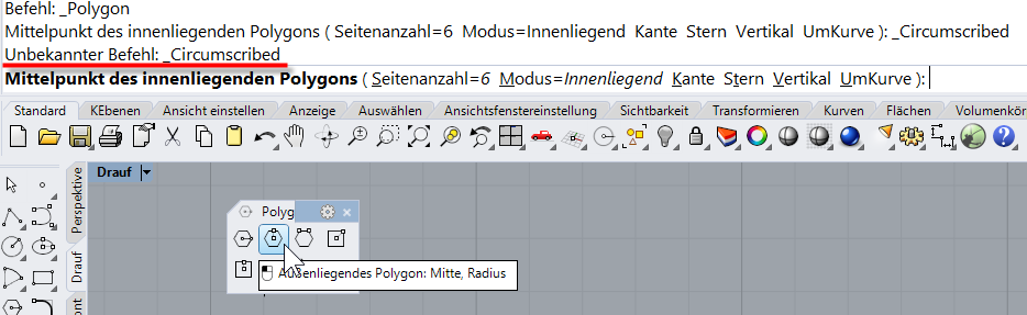

This doesn’t work in a German version of V6 SR7:
! _Polygon _Mode=_Circumscribed
The button command is
! _Polygon _Circumscribed
Doesn’t work as well…
Hi Charles - please run _ToolbarReset and then close and reopen Rhino to force the newest toolbar file.
Any better?
