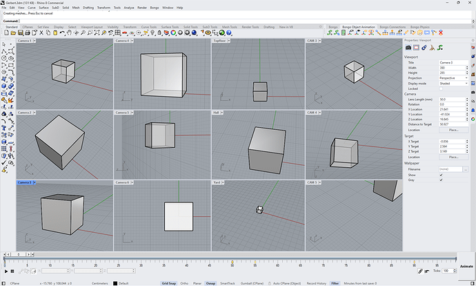

In the old days, 3D animation was my thing. Recently I’ve been printing, mainly quite large objects. Sometimes our clients want a good old fashioned animation of the print-to-be, so I decided to give Bongo a turn. Seems nice, but something is puzzling me. In any animation tool, it would be possible to create several camera’s and easily switch between them. In Bongo it seems the only solution is to use the Bongo Animation Sets. Opening this tab again and again does take some time. Is there a better option to switch between camera’s? Best would be to hit play and use an arrow key to select a different camera.
Hi Gerbert, welcome to the community.
Animation sets serve to make identical objects behave differently. It won’t help you to create several cameras and easily switch between them. Indeed in Bongo switching in between Views isn’t feasible during a Preview of an animation.
A straightforward technique might be to make various ‘takes’ of the scene from the desired various camera-positions (you can easily define them using Named Views) and combine the ‘takes’ in some post production application (e.g. Adobe Premiere or NCH VideoPad)?
Luc
Hi Luc. Thanks! On the topic: I did try named views first. If I keep the windows open, cam animation works, but when I close the windows the animation is gone. It seems the cam anim is only stored temporarily? When I use animation sets it’s a matter of double clicking the camera and all is fine, animation is there. The only thing is you can keep the named view panel open and the Animation Sets panel not.

Correct. Well, for now yes. I think most of the stuff will be just camera movement.
As far as I understand the animation data of a View is stored somewhere in the Viewport data window itself. You’ll notice that when you close an animated View this dialog pops up.
This includes that every Viewport can have its own animation, its own camera.
Rhino allows you to have as many Viewports as you need. This gives you the ability to create a monitor screen similar to the ones security people are used to.
In Gerbert.3dm (131.7 KB) 3 Views are animated = 3 Cameras. Still no switching though. I guess this is the best Bongo can do for you.

I just made a file where I have 20 ready views, all with animation enabled. next time I just insert a rhino block and start animating. This works, I think I’ll keep this as a standard procedure. Thanks!
