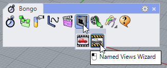

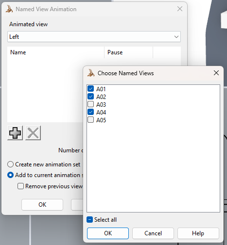

You can render a named view animation directly from the Named View panel with this button
It looks like you just created view keyframes from the named views. If you look at the Bongo View Properties and turn on “Show camera path”, “Draw points on camera path”, and “Show target path” you’ll get a better idea of what’s happening to the view. The Camera command might also help.
The view animation has a bunch of sharp turns and the target shifts around making the animation jerky and unpleasant.
I would suggest trying to constrain the view target since it appears to me to be the main issue. I don’t think Bongo is smart enough to just know how to create a pleasant blend between Named Views. It blends based on the tweens on the keyframes. Giving it more information about how to get from A to B with more keyframes/constraints would be a good start.
if I press the suggested button than I only get the animation parameter for the Rhino view animation but I see no way to render this camera movements. It would be great if the user could select views from a list, set the order and render this view animated. An option “pause per view in s” could allow to get smooth pauses at every position.
The Bongo setup was a test what happens if I save the different views to the time line. Right, the default camera movement interpolation is jerky. This test shows how difficult it is to render a camera animation from view to view per Bongo. I expect a smooth movement like from the basic Rhino view animation but the tweening isn’t pleasant.
So, we have a basic Rhino view animation which can’t be rendered and a not smart enough Bongo tweening. What will be the solution for the future?

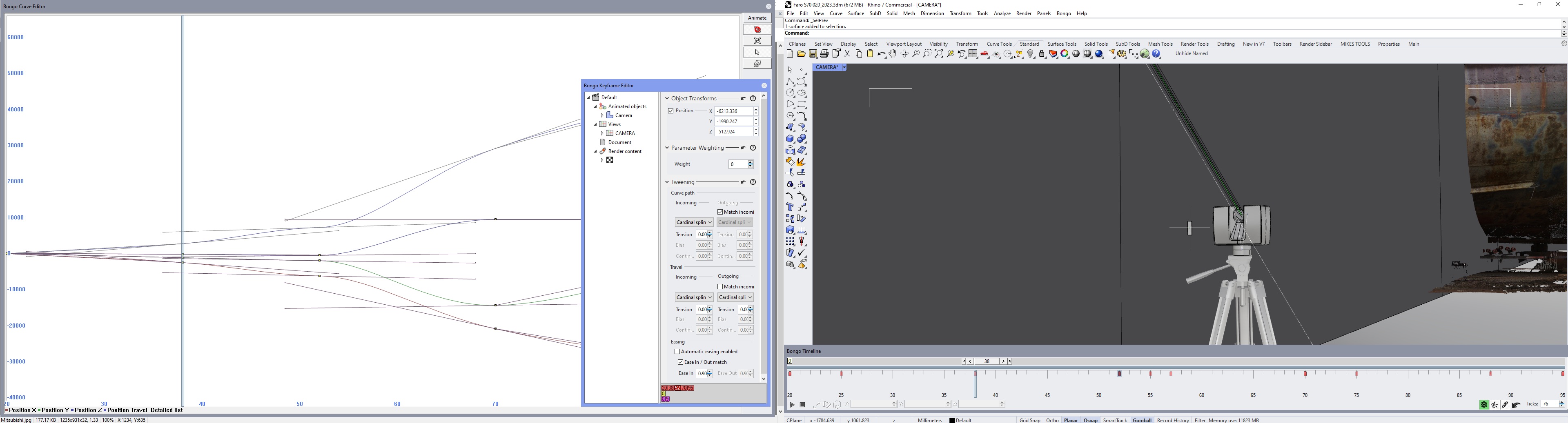

The other issue I find with Bongo is the “Ease to / Ease from” keyframe commands dont really work that well so it is still hard to get a predictable result.
I assume it is this section in the KeyframeEditor you are referring to.
Have you ever examined the effect in the CurveEditor?
Doesn’t appear unpredictable to me.

I have fixed the issue with my camera movement, is there a way to manually grab the end of the “Lever” (Handle) and drag it to where you want it ? I found I can control the lever length using “Tension” which works well.
Also, you can see the curve editor is quite busy, is it possible to isolate one aspect of the movement, IE, X rotation, Z rotation etc ?
Regards,
Mike.
In the Tweening section of the Keyframe Editor you find the option “Custom”
This option offers ‘handlebars’ (the official name for “levers”) to control the curve at your discretion.
At first the handlebars are rather small (namely 1 tick) –you might have to zoom in to see them.
As you see the Tweening options are also available in a right-mouse-click menu in the Curve Editor.
The ‘Custom’ option however is not available for Position data of a Object-animation with 3D-tweening enabled, and neither for Location in a View- animation when ‘Spherical tweening’ is not enabled.
In both cases the tweening of the motion is split up in 2 aspects; the curvature of the path on one hand and the speed of the travel along that path on the other. I assume the algorithm for combining both is too complex to allow interference by handlebars (is it @Joshua?). BTW The same splitting Curve path/Travel also occurs for some Properties like Color, Difuse color and Glossy Color.
