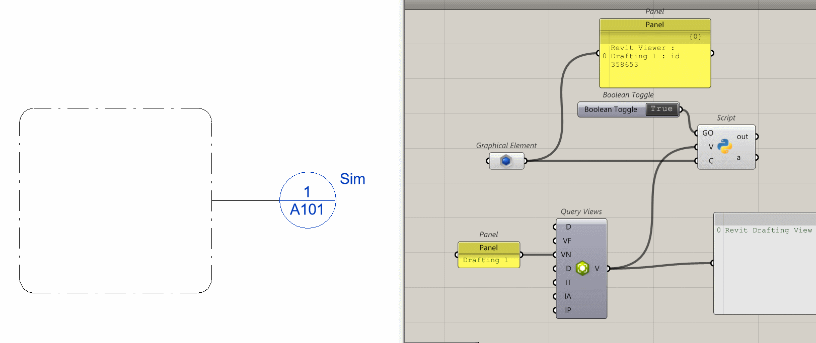

There isn’t a component for that.
Here is an example using the Revit API, not quite understanding the reason for requirement of checking the ElementID is greater than the other.
Here’s something to get your started.
R8-RiR_Change_Ref_View.gh (12.6 KB)

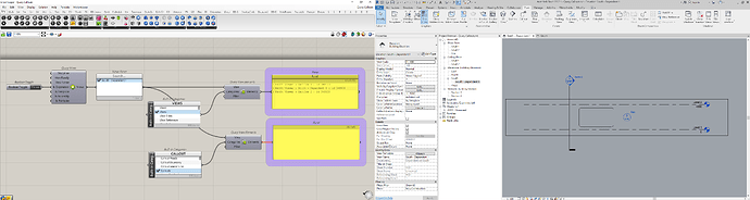

Additionally, I wonder if “Callout” can be queried or filtered separately from views?
In the image and file attached below:
Query Callouts.gh (10.1 KB)
Query Callouts.rvt (5.1 MB)

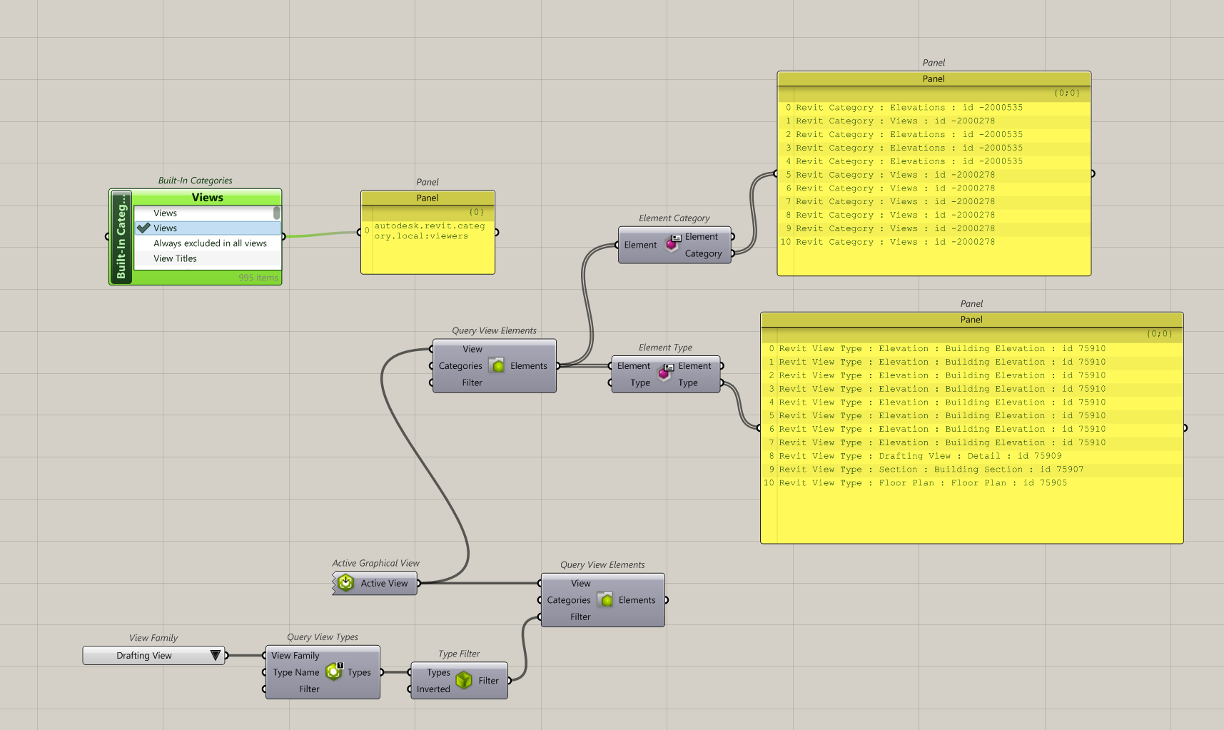

Hi Ctu6,
Callouts category is referring to graphical elements (linework) in the Revit API.
I think something like this might work for you, Query View Elements filtering by View Family Type

I think I’m still a bit confused here.
When querying from the view, all the types are the same (none of them are Drafting Views).
How can I specifically query only the Callout reference ones?
The reason for doing so is that I have two sets of reference drawings (likewise, two sets of sheets) for the same callout location, and I have to constantly swap between them.
I’ve thought of duplicating the callout at the same location and using a filter to control the visibility, but somehow I think it’s more efficient if the referencing can be altered directly.
Your script from the previous message seems to do the trick!

I think you’ll want to filter by the name/number or a custom parameter, you’ll need to be specific at some point if you’ve got multiple callouts you are changing on a sheet.
To narrow it down it looks like in the case of a section callout reference it doesn’t have a scope box parameter, so you could cull the list that way.

Thanks for the script; it’s working now!

In the meantime, I found that ‘Query View Owned Elements’ also helps filter the Reference Callout, except in situations like dependent views where it won’t return the element (View Owned, of course).
