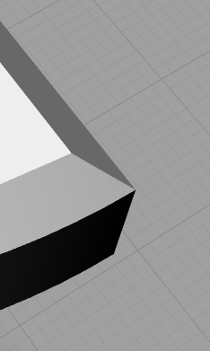

Hi I’m having trouble carving off the corner to form a triangle surface like in the second picture. The second picture is exactly what I want. That was successful in two corners, but not the third corner. What I did was I believe I chamfer edged all three corners simultaneously, but that left me with one corner that is not consistent with the other two.
Hi Lisa - try doing all of the chamfers that connect to each other in one operation. Does that get it?
