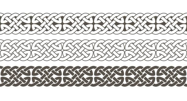

Hi, I’m struggling with some details on this repeating pattern for a series of ring designs. I’d really like the 2 line intersections (on the pattern that does not join to a continuous curve) to intersect and shatter each other as the self-intersections do. But I just can’t find the logic to make it work.
Also, I’d like the cuts in the boundaries to be parallel to the cutting line, not perpendicular to the line itself. Does anyone have any ideas how I’d do that?

Supposed to look like this
I managed to get the first knot to work because it was a single curve self-intersecting.
do you think it is possible to make in such a way any knot could be calculated always and solely as a single curve like you did in the above?

took this from your GH file and connected top and bottom through this yellow line and joined everything together
I would like to say it worked, but it didn’t fully :frowning: I’m very sad, gonna have a gin tonic
[edit] ok, it works after simplifying some non-sense :+1:

First of all, your GIANT GH file has some irrelevant internalized geometry that can be deleted.
celtic_pattern_clean.gh (9.8 KB)
Second, you have some Join Curves components that are doing nothing because the curves don’t touch end to end.
I did some refactoring up to the point where the intersections and curve Shatter are done but need a break so left the culling alone.
celtic_pattern_2022Oct2a.gh (15.8 KB)
P.S. For amusement and consideration about culling, I added the white group.
celtic_pattern_2022Oct2aa.gh (29.3 KB)

Another approach using Rhino.Geometry.Curve.CreateBooleanRegions()
celtic knotwork.gh (17.3 KB)
Your “simplified some nonsense” can be further simplified, eh? By applying Dispatch directly to the output of Shatter. I love it!
gin_tonic_2022Oct2a.gh (16.5 KB)

You need two Fennec components to create the final result: Regions and Offset to point
knotwork_.gh (21.4 KB)
