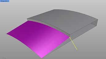

Hi, here is a little problem I encounter everyday- unable to do cap… actually I am careful enough to the edges that I am going to do cap/ planar surface, but I always stuck here checking every edge related, even worse I have to untrim, extend and rebuild every surface related.
In the attachment I tried
  1. cap (failed)
  2. planarsrf by picking edge (failed)
  3. duplicate edge curve=> join curves to closed one=>planarsrf (created)=>join (WORKED)
    Okay…why? whats the difference there?? Tolerance?
Hello- for now, Explode the object, RebuildEdges, Join, then Cap. I do not yet know why this is needed…
Just did the steps you suggested few seconds ago, still cannot cap. ( red surface is the one created by closed edge curves)
Hi VinPo - leave the red surface out - just Explode the polysurface, RebuildEdges on the resulting faces - all at once works - then Join and then Cap the result. Here that resulted in a closed object. Any luck?

Hi VinPo
Your problem is where the arrow points to, in the pink surface. Just untrim the surface with maintaining the border, re-cut it again, join all, and then the cap command should work.
Ops, how can you find this problem? I should have all surface point alligned straight (setpt) from top view…
this is always my reason to get stuck with time lost- unable to discover the problem
This gap is why cap fails
unable to do planarsrfx.3dm (113.8 KB)
Notice that if you extract that surface, you will find two different end snap points at that corner of the surface. You can create a point at each of these end points. In theory, that is impossible for a valid Rhino surface and yet Rhino claims the surface is valid
I tried DupBorder and that fixed the gap.Then planar surface worked.
