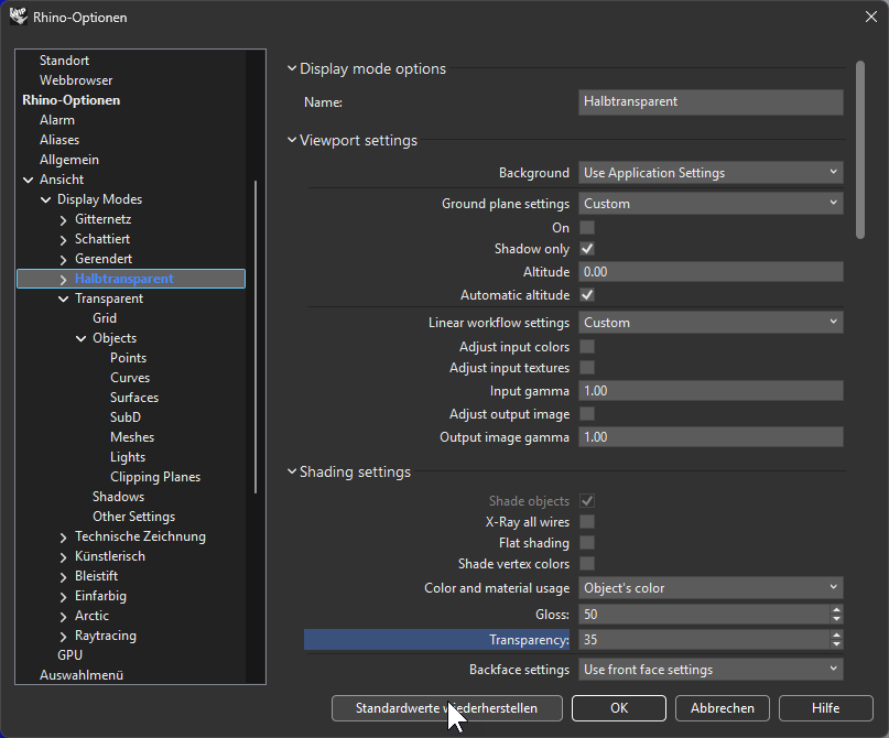

Can't reset Ghosted display mode
I can’t reset Ghosted display mode to default.
For other display modes it works.
(9.0.25184.18305, 2025-07-03)
Thanks for you reporting, I found it works fine in RhinoWIP (9.0.25187.12305, 2025-07-06). I have sent a download link to you via DM
Tried it, but no luck.
I tried with German and English UI.
Perhaps it’s a regional issue?
Windows is in German.
Hi Charles -
What happens when you delete the display mode, restart Rhino, and make a modification?
Aha, that worked.
When Rhino was restarted, I had the altered (blue) Ghosted back again.
Then I modified Transparency.
And clicked Restore Defaults.
The Defaults were restored, blue is gone.
Then I quit Rhino and restart it.
Ghosted is blue again and can’t be reset to default.
Couldn’t make a YT make sense before this gets lost?
I still see the issue.
