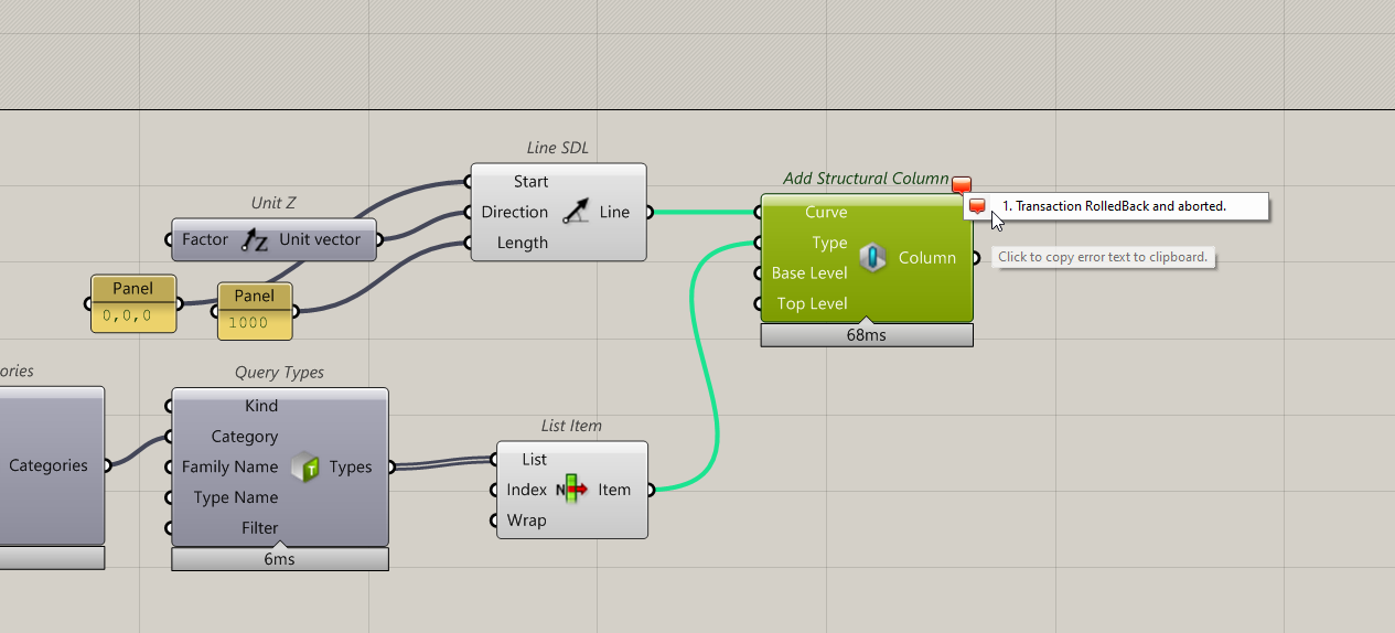

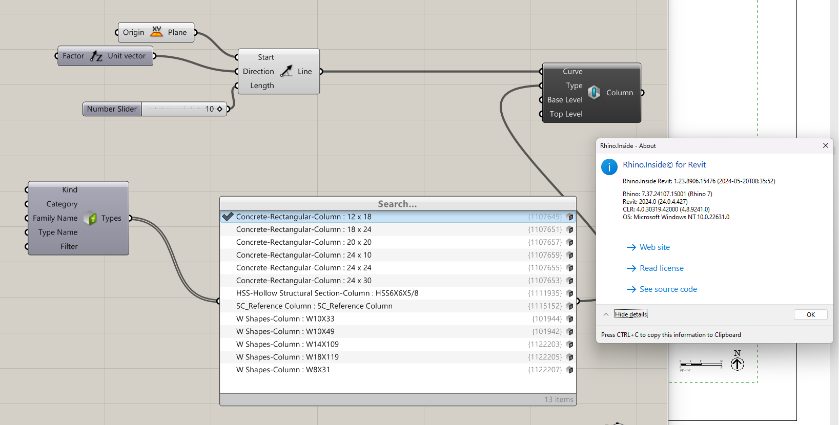

Hi there,
Seems like I can’t create or modify structural columns at the moment.
Rhino.Inside Revit: 1.22.8906.14842 (2024-05-20T08:14:44)
Rhino: 7.36.23346.16351 (Rhino 7)
Revit: 2024.0 (24.0.20.20)
I have also tried this on the daily build (1.23.8907.21534) and I had the same error.
It seems to be particular to only concrete columns.
Thanks in advance!

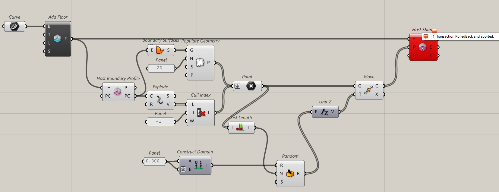

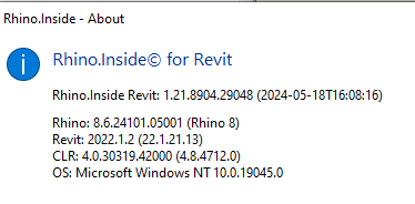

@Japhy @kike
I was assisting on project and been facing a similar issue but with a different component, “Host Shape” when trying to add points to a floor.
I have tried with the below versions with revit 2022 and one time with revit 2023, with no luck… any prompt suggestions would be of great help.
Below is a sample I setup for your convenience.
RiR_Components Error.gh (11.0 KB)

I did a bit more of checking because i remember I was using it on a different project couple days ago and it was working fine… but in the other project I was only working with corner points of the floors.
As shown below when the point in the middle is in plane they get added fine in revit, and once it moves out of plane it gives the error, hope that might help.
