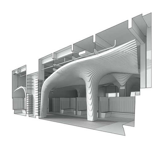

Can v5 create lne rendering?
I need to discover the best ways to render architecture buildings as a wireframe image under vray enviornment.
I could use “varyedgetex” material to do it. however, last time i tried, some lines were missing. Is there any other better way to do it?
If there is no better way, does it mean I still need to use 3dmax to render my buildings?
Thanks.
can we do the rendering as attached in Rhino Vray?
Yes, there’s a toon shader in V-Ray for Rhino

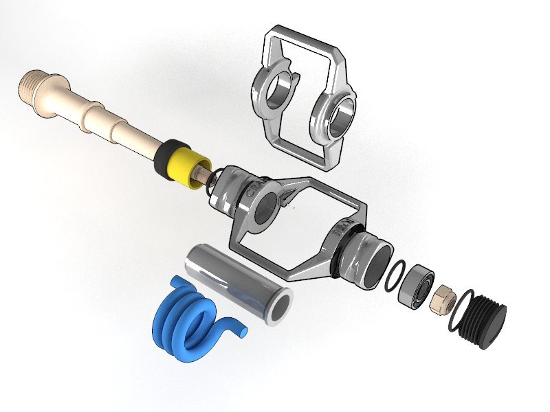

V-Ray’s toon shader is extremely powerfull because you start with any V-Ray shader and add a “toon effect” on top, as you can see in the screen capture:
The effects can be from flat shading with strong outline to realistic material with an outline added for emphasis.

where i can find toon shader? it looks it is in the material lists, however I can’t locate it.
In the material editor, you create a new toon material and you then select a normal V-Ray material as the base.
You select the base material, in this case I chose “Red dull” which is a standard V-Ray material I created beforehand. The settings underlined are what I play with.
Marc
That was over-the-top helpful. Great explanation.
Another good use is when you have a very shiny material in a bright environment & white background. Its almost impossible not to have an edge ‘blow out’ and disappear against the background. In that case, I will make a toon version of the material (usually chrome) and add a 1-pixel outline in medium gray; the black default line can be too dark and gives it away.
