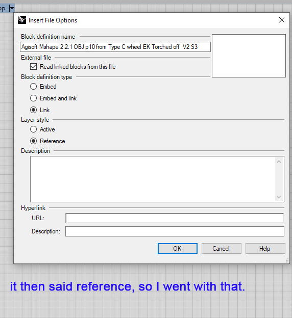

here is the dialog box when choosing File Insert in Rhino V5
What options should I be selecting. ?
Also I dont see linked that you mention. and thats important. to select you say.
I have a new mesh made in metashape 2.2.1 and wish to see if insert behaves better than import.
Cheers
Steve

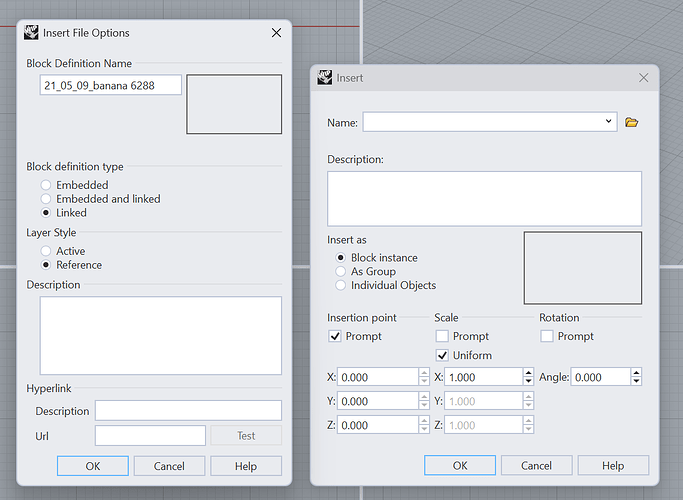

I like to insert my meshes as linked, referenced blocks but in the end that also depends a bit what you do with it afterwards…
Most of what I do is in Grasshopper and for some things I don’t even need to import / insert a mesh in Rhino and can do that directly in Grasshopper since V8.
Definition type and Layer Style are set in the next window…
You can also change these things later on…
I don’t remember how this looked in V5.

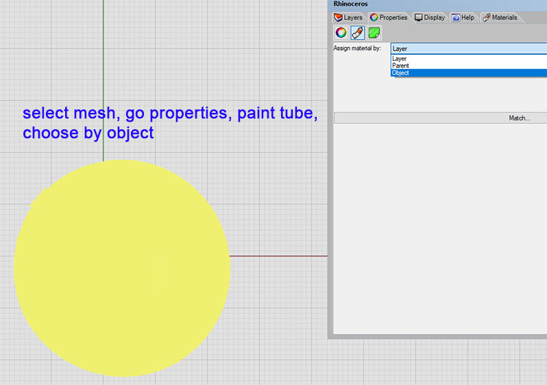

then when it appears, do the usual steps, , select it, go material, by object, color, browse to jpg,
BUT still get a black item after rendered chosen

Usually you do not need to set the material if the three files are in the same folder.
The material is set to the mesh in the block and not to the block.

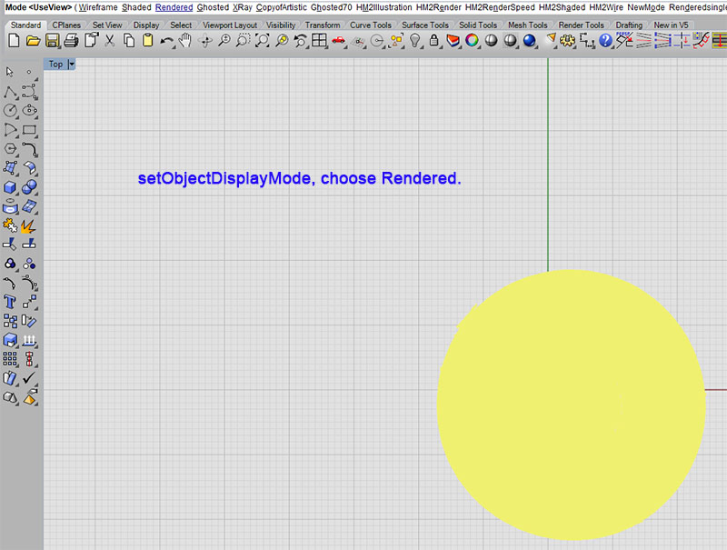

Instead of SetObjectDisplayMode, have you tried to simply change the viewport to Rendered?
Insert, block, reference
dont go to material tab etc,
make window rendered, and the texture appears. :grinning_face:
so then back to shaded, select it, setObjectDisplayMode choose rendered. its BLACK. :rage:
I work on the item in shaded mode, and ghosted mode, and wireframe mode etc etc. so need it showing its hi res texture in these, hence setObjectDisplayMode for the mesh.
so the rendered window is no use to me.
I then try for the Import method, and object, color etc the usual, and get a lovely textured Object in all my view modes. :grinning_face:
But its potentially going to be SLOOOOOW
as Rhino is bad with meshes.
even the 2nd mesh in the current project is now causing slow panning, turn it off and slick again.
Steve
If you want to do that, linked does not work.
By running the command SetObjectDisplayMode you set the display mode of the block and not the mesh.
You can try to insert embedded or embedded and linked and then doubleclick the block to edit the mesh. Then again SetObjectDisplayMode

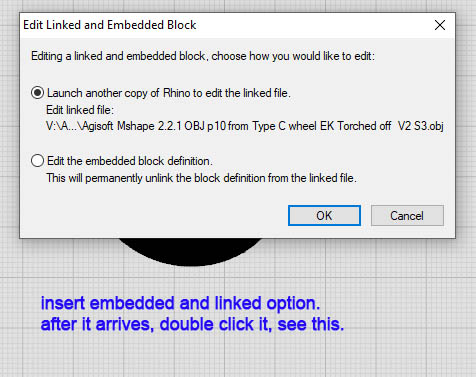

so try insert block, embed and link, then double click ut, and see this
so what to choose in this dialog box ?
then what will appear next and what there to choose, etc ?
linked would seem a quicker way than embedded items , am I right ?
less Mb to save for starters.
so Embed and link puzzles me. how can one have both, whats the advantage ?

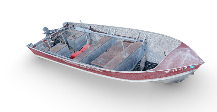

My experience is considerably different than Steve’s experience.
I create large meshes (up to 10 million faces, occasionally larger) using Metasahpe, import or insert them into Rhino, and manipulate them in Rhino without the problems or frustation which Steve describes. I do not use any third party plug-ins for meshes, reverse engineering or similar. The imported meshes are used as reference in creating NURBS models.
  1. Creation of the meshes in Metashape:
    I create a dense point cloud in Metashape, trim superfulous points, then create a mesh from the point cloud. I trim the mesh if needed, decimate it as appropriate. If the decimated mesh will be substantially over 10 million faces I usually split it into two or more meshes. If an area needes higher resolution (less decimation) I create a smaller mesh with less decimation. The final meshes are textured in Metashape. I do not edit the textures created by Metashape.

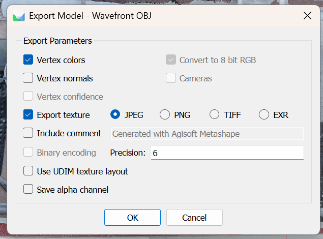

  2. Export of the meshes:
    I have been exporting meshes from Metashape in .obj format. My usual settings are:
    For each mesh exported three files are created: .obj, .mtl, .jpg
    Note that the meshes of the yardsticks used for scaling are in separate files.

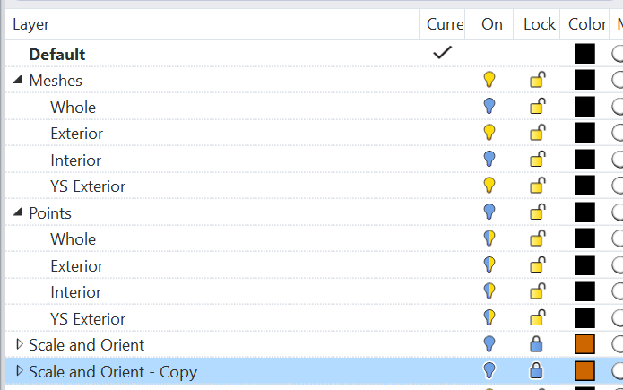

Typically all the reference meshes associated with a project are saved in different layers in a .3dm file. I frequently also export the dense point clouds from Metashape and import them into Rhino.

    I have been using Worksession with the NURBS models in a .3dm file and the reference meshes and point clouds in a separate .3dm file.
    Recently I have been experimenting with inserting the meshes as linked blocks, primarily to allow for re-orienting the meshes.
