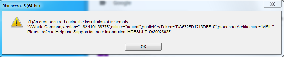

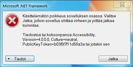

I was about to open my Rhino chair file to make some small modifications, and print the technical drawings - when I run in to this (attached).
Can’t open the Rhino file, and not any other Rhino files either. Not even the whole program. I get this funny window which I can’t even close (have to close the whole computer and open it again).
  • What might be the issue?
Thank’s!
Ps. literally the translation (from Finnish to English) would be something like: unfinished exception with the application. Choose ‘Continue’ and the app tries to pass the problem and continue operating (but it didn’t work).

Which version of Rhino are you on?
For starters, I would try to repair the installation of Rhino and see if that helps. Go to the Windows Control Panel > Programs, select Rhino and click Repair.

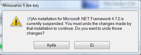

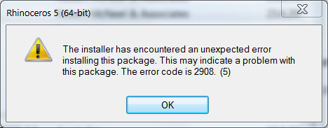

I seems to get all kinds of warnings from ‘serious issues’ (screenshots in Finnish language attached).
So it didn’t work out.
Thank’s for the tip!
Johnny
If it were me, I’d run this Microsoft .NET repair tool:
https://www.microsoft.com/en-us/download/details.aspx?id=30135
Didn’t help, but thank You John anyway!

If it were me, I’d first make sure my Windows was fully up to date with fixes from Microsoft, and restart Windows.
If the problem persists, look in Windows’ Check for Updates - View update history for failed updates.
After that, uninstalling and reinstalling Rhino.
Does Rhino start in Safe Mode?
Hey, it worked!
I checked all the updates for Windows and Rhino / T-Splines works perfectly.
