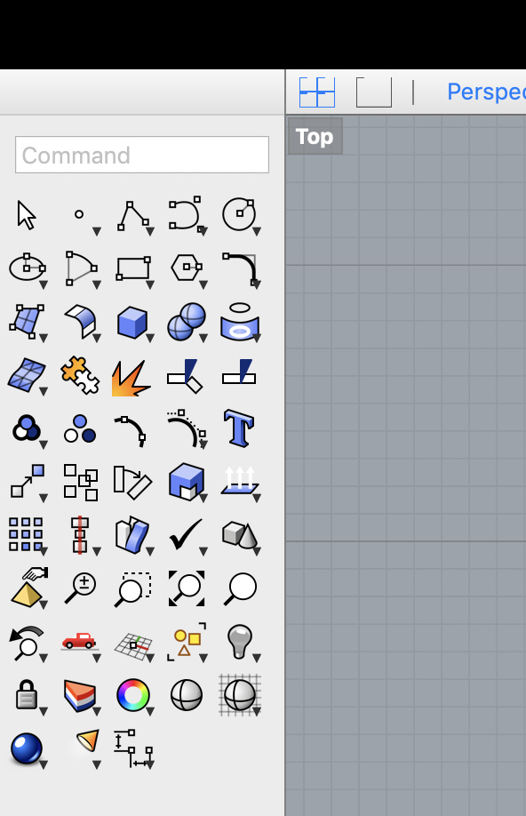

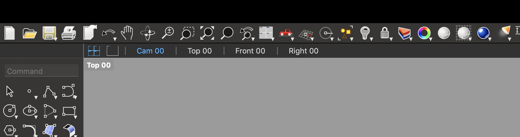

  • Rhino Mac has a bug when you expand to full screen in that there is a black bar at the top. In order to get full screen without the bar you need to click the green minimize button and then click it again to re-full screen.

This is unlikely to happen, because development is already largely underway for V6/Mac, so corrections to the current V5/Mac will likely be bugfixes only. Also no previous version of Rhino has ever been able to open the next version’s files…

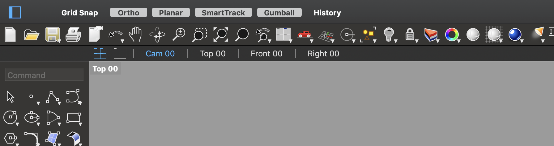

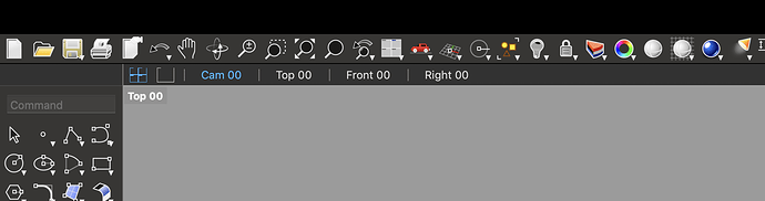

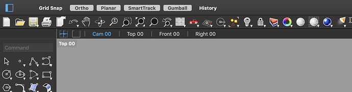

Yeah, this is strange. It happens to me when I have two or more files open.
First file:
Second file:
