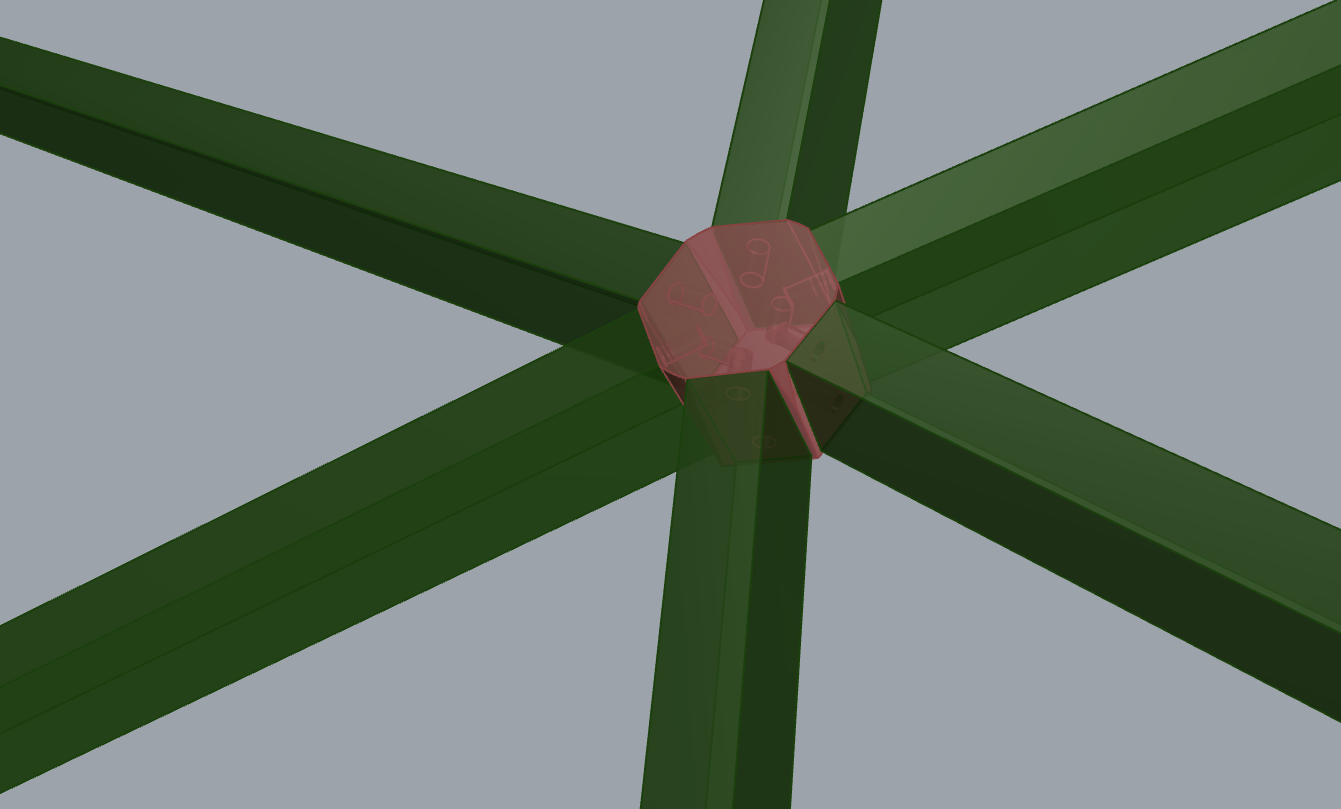

I have a triangular gird over the surface, this grid will be rectanular structural member, there will be a connection to hold those members where they meet at one point. I am facing a problem, please see below.
  1. Angle between the edges and its length is always different. I want to have node specifically made for that particular meeting point, hence I want to find t parameter on respective lines, value of such t parameter shall be like, when rectangular member is generated using this t-parameter it shall not intersect with any other members.
Possible soln: what I thought is to create range between 0,1 with (100 more/less values). Then treat each value of this list as t-parameter to generate new member and check the intersection with other member, this process shall be continued until there is no intersection found. I am looking for efficeint solution.
Any help in this regard would be really nice.

See this old thread in the old (dead) Forum: get the latest C# build posted and adjust/mofify the Method(s) used in order to best suit your goal(s).
A smarter way of doing this - Crash detection - Grasshopper
Anyway the orthodox approach on similar issues is to treat your stuff as a 3d graph, do the connectivity (VV), locate the possible islands using solely the VV tree (General graph case [random proximity graphs and the likes] : NOT included in the stuff that I have posted, since is internal) and then use Trigonometry on each min angle per node (or the min angle per graph and per island) for dealing with real object clash issues.
That said the min angle per node is a classic double loop (for each node against each neighbor nodes [ from the VV tree]).

On the other hand for simple cases you can skip the above by sorting the Neighbors (if the graph is a Mesh there’s a Method for this [related with MeshTopologyVertices not MeshVertices]).
