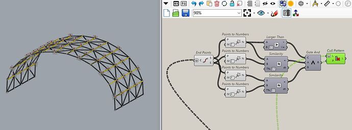

I would like to parametricaly reduce the lenght of the frames of gridshell and space structure at nodes connexions to avoid claches:

Using a sphere to trim those curves.
Rhino_aghry8oxwQ
clash avoidance.gh (37.7 KB)
Thank you
However, what I’m looking after is a solution to parametrically optimize the lenght of each frame :slight_smile:
Each frame should be reduced just enough to avoid the clash.
The lenght reduction is not the same for each frame.
your model is a half pipe. This means you need just 6 diferent types of nodes (most values are constant). I will use just one value for all connected members (its faster and cheeper). For nodes design you can use excel (in case your model is more complicated). According to your node normal you have 3 angles (horizontal, vertica and torsion). I would simply design the nodes in Rhino/AutoCAD.
take a look at this. I’m kinda busy so there may be illogical operations. (Also you need Peacock plugin.)
Gridshell and space structure frames parametric lenght adjustment at nodes connexions to avoid claches.gh (47.9 KB)
In addition, it would be better to find the bisector vector of each axis and orient the rectangles accordingly.

Below is the code edited to calculate all edges at once. Also the bars are oriented according to the bisector of the edges.
shorter_name.gh (31.0 KB)

To get back on the topic, horizontal bars get out of plane at kinks:
I would like the horizontal bars to get down to the position in blue on this sketch, but I don’t manage to achieve this.
Any idea to solve that?
Select construction planes
or lines
then move along the bisector.

as @leopoldomonzani said, you need to move along bisector. Doing this manually in a geometry with variable angles can be really tedious. In this case we can use the basic trigonometry.
shorter_name _1.gh (41.2 KB)
