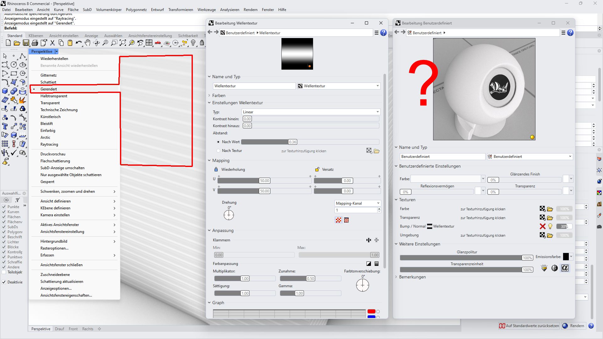

Bump not in the preview and in ray tracing
Hello, when rendering the preview, the bump material is displayed briefly, but then disappears. In the scene, the waves can be seen in “Rendered”, but not in the “Raytracing” setting. What am I missing?
Please select the object with the material applied and File > Export Selected as a new 3dm file. Attach that here and we can check.
Here:
Test.3dm (1.0 MB)
I believe I fixed this in 8.13. Here how it looks in what will become 8.14
Thank you very much!
