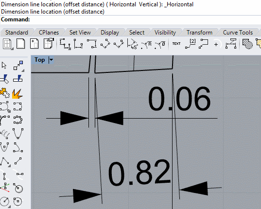

If I use the horizontal dimension button (In the Dimension Tab) it should always create a horizontal dimension no matter how I select the points.
If I select points that are more vertical than horizontal I get a vertical dimension when I expect a horizontal dimension.
The same issue exists with the vertical dimension button.
Hello - I think the bug you see is what @wim reported. - can you confirm that if you place the dims in the Front view it works as expected from the buttons?
Yes it does seem to work okay in the front view.
Most of the work I am doing now involves working with 2d shapes and I use the top view for these jobs.
I didn’t think of trying a different view.
Thanks, Jamie.
I also ran across this bug today. Very surprising in such mature software. Did it break recently from some related update?
gif
Btw, I am able to create a vertical dimension when the gap is very large. I only see this when I want a vertical dimension from an almost horizontal line.
EDIT: I can confirm it is broken the other way around as well. I tried to create a horisontal dimension from two points with mostly vertical separation, and Rhino forced a vertical dimension on me instead.
