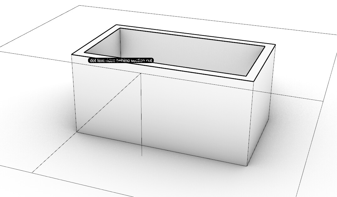

BUG: Dot text rides behind section cut
Dot text rides behind clipping plane section cut.
dot text rides behind section cut.3dm (334.4 KB)

Seems to be correct in V8/WIP.
Nope, not for fills.
RH-68969 Dot: not in front
