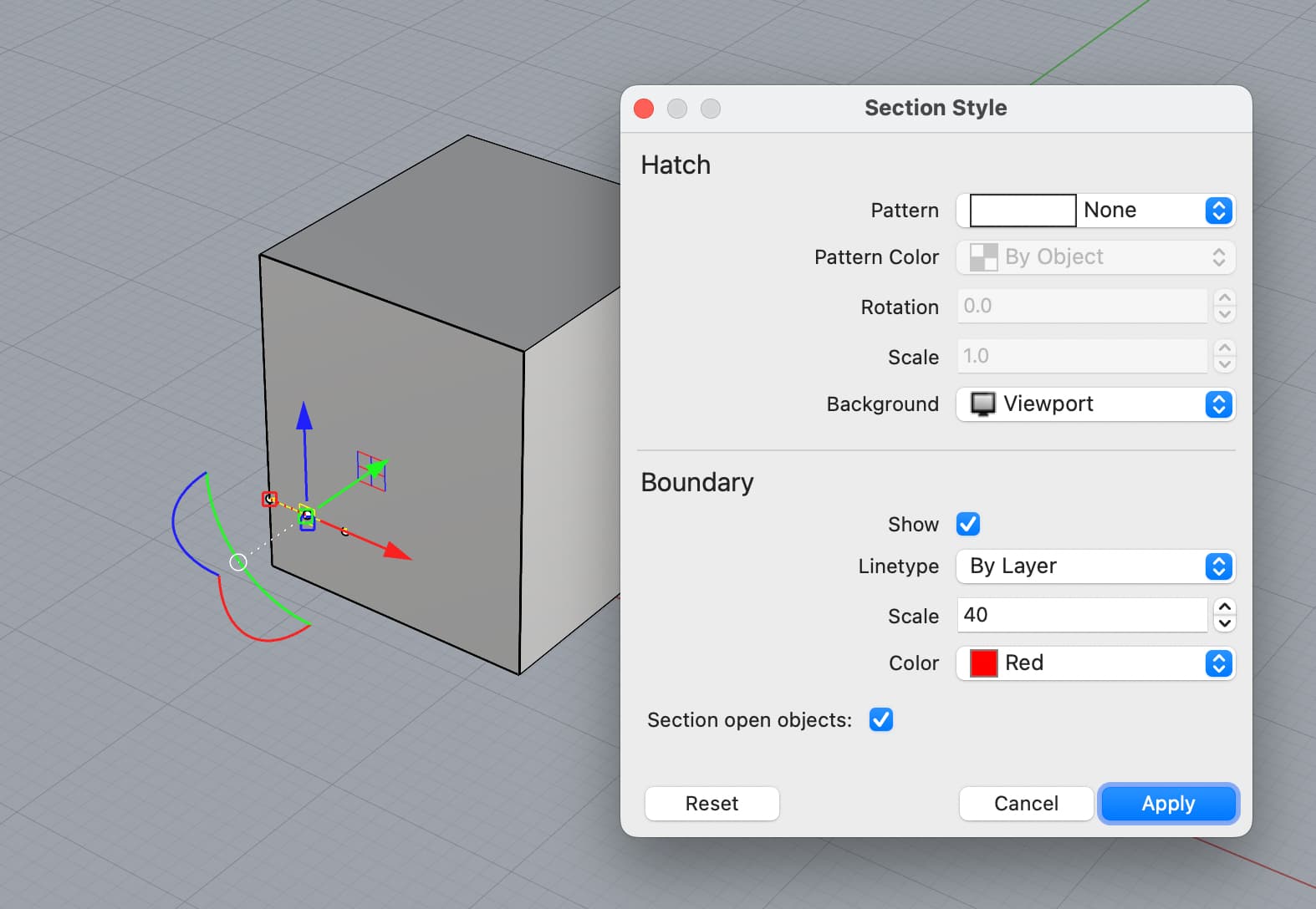

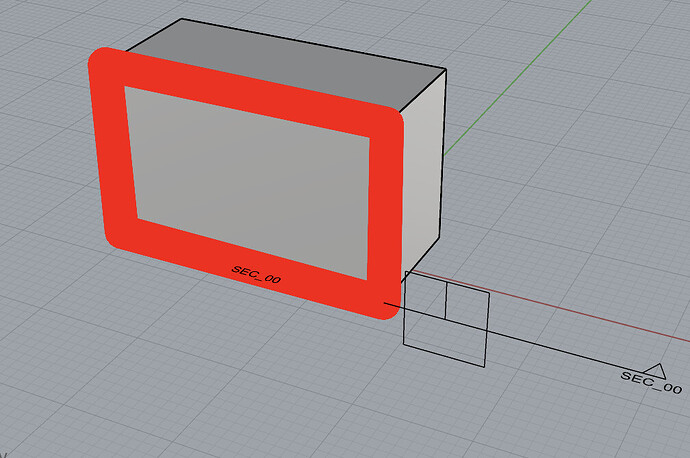

BUG – Custom section style not showing
Rhino 8.1 for Mac.

Your object’s section style is set to “By Layer” and you are changing the section properties of the clipping plane. You’d have to set the object to “By Clipping Plane”…
Right, thanks.
