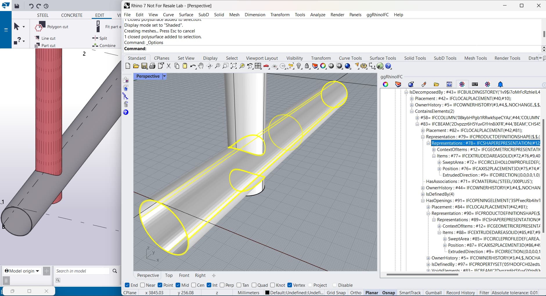

If you export constructive solid geometry in the IFC using the fabrication model view settings, then there is no faceting for extrusion based elements. Here is an example of a CHS beam being cut by a CHS column.
Note in the tree view the shapes are extrusions with circular profiles, no faceting.
Here is the resultant IFC import using ggRhinoIFC in Rhino
230728 rhino import.3dm (408.5 KB)
Here is the Revit import using ggRevitIFC (note native elements with families that can be modified)

Based on the images the workflow show work. But if you test and don’t get good results, I can help review and look for improvements. There can be a trade off in reliability, Tekla has superior capability than Revit in terms of cutting parts etc, but if the model is quite typical, this should work well.

Doesn’t look like fabrication model view to me, but I’d need to see the ifc file to be sure. I’ll send you a message.
Make sure the fabrication view is nominated from the Tekla export settings as per this image.
