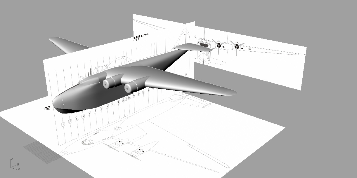

A model I did for fun back in 2009, Vray render.

Are you using the correct airfoil for the main wing?

The wing profile was just eyeballed from the 3 views. I can´t see how this plane would fit in a soaring simulator as it is not a gilder…
At the root is this one
and at the tip of the wings is this one
At the tip add 2° degrees of “twist”. In other words, rotate the NACA 0010 airfoil at the tip anticlockwise so that the leading edge is up. This prevent the Plane to stall at the tip and increase performance. Helps visual quality of the 3D build.
For the tail (horizontal and vertical airfoil) use only one NACA. Just scale the 0010 to make it thicker if needed.

This description is flawed. The reference to “anticlockwise” is moot as it is image-orientation dependent. The reference to “leading edge up” is exactly the opposite of that which is desired to effect “prevent[ing] the Plane to stall at the tip.” And the use of washout has very little to do with airplane performance except to slightly diminish performance in the pursuit of safety at the stall.
The correct way to control stall behavior using wing twist is via “washout” which is defined as twisting the wing tip leading-edge down thereby reducing the angle of incidence at the tip with respect to the angle of incidence at the root. Twisting the wing tip leading-edge up is called wash-in and is generally detrimental to stall behavior.
(Other methods of stall control do exist, but are beyond the scope of this comment.)
Yes, that’s true, sorry I was thinking in my wing sails when I wrote that.
